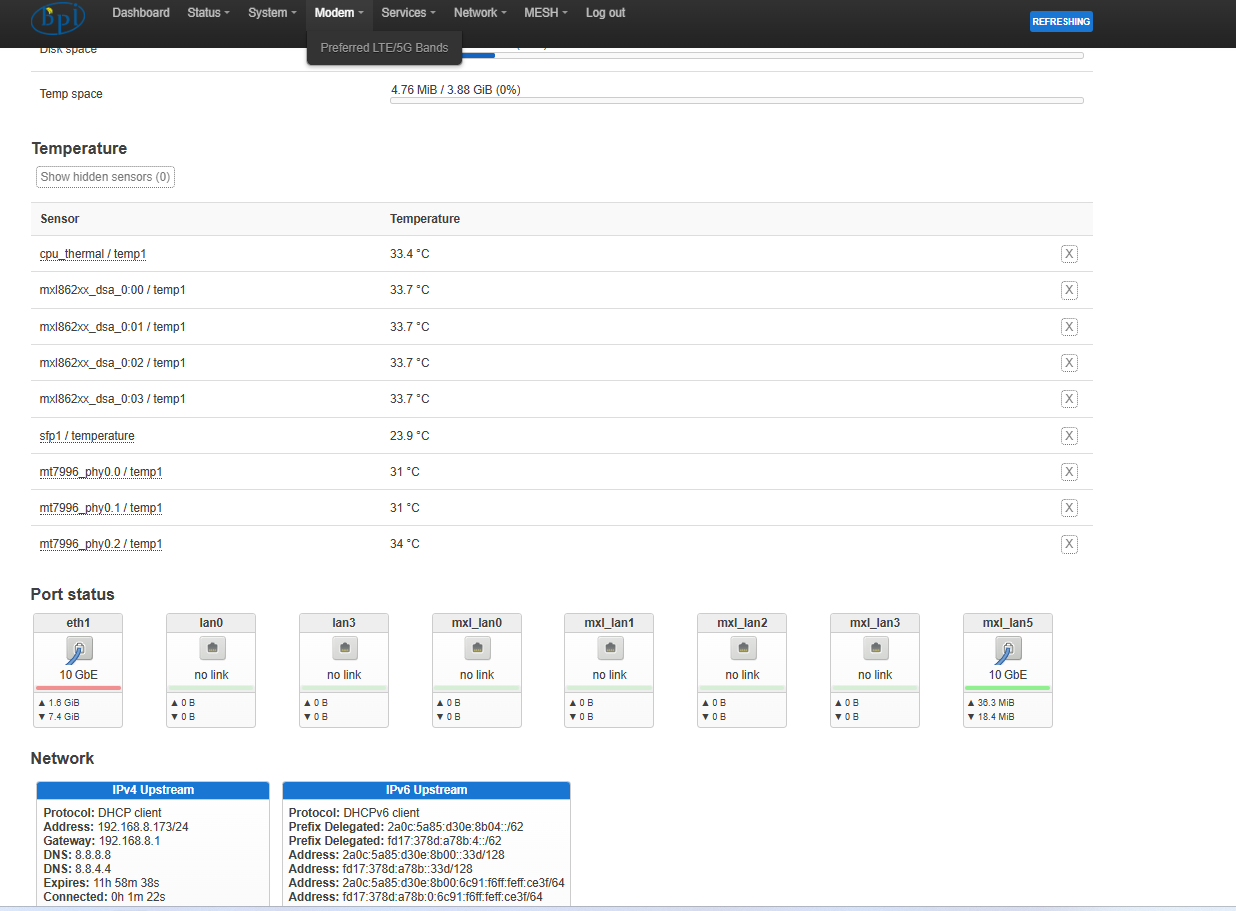

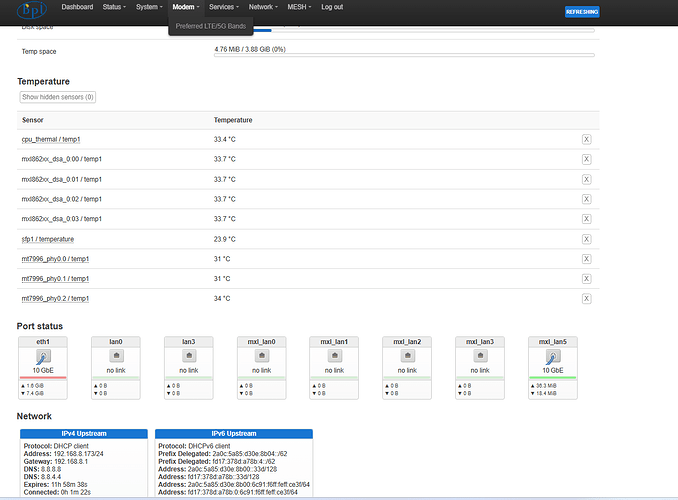

Statistics have been enabled to continuously monitor the router’s operation: CPU(s), interfaces, wireless, system load, and memory.
CPU Load and Temperature monitoring have been added to show real‑time CPU load and temperatures for the CPU, SFP and Wi‑Fi card, so you can see operating temperatures.

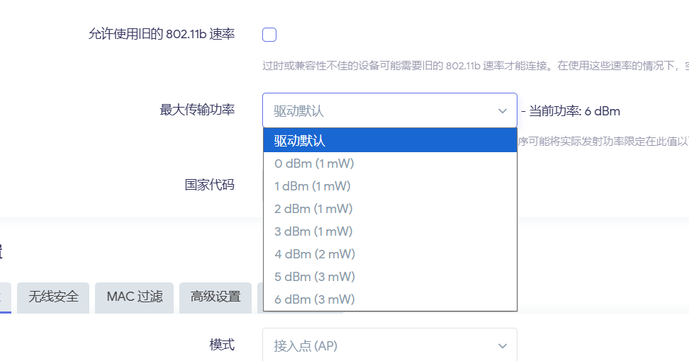

Experimental regulatory / power adjustments — a patch was made experimentally to remove some restrictions and set channels to maximum transmit power across the three bands. Note: I only adjusted transmit power for the 5G and 6G bands; for 2G I left the default power. An option was also added to manually configure per‑channel transmit power so you can comply with legal limits in your country.

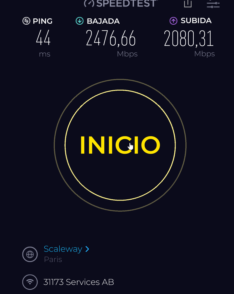

Good evening, I’m leaving you my latest image with what you need to set for manual IP to work:
19-02-06
192.168.1.156
255.255.255.0
192.168.1.1
192.168.1.1
Wi-Fi installed with high power and no restrictions for any country
PASSWORD 123456778
BANANA 2G
BANANA 5G
BANANA 6G
The first time it won’t give you internet, reboot and you’ll have internet. I’m leaving you a photo of a bit of what’s installed and the speeds with WireGuard to 1,500km from my house.
Both through SFP+ and WiFi 5 and WiFi 6.

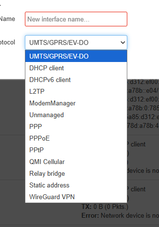

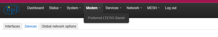

You also have installed to be able to use the 4G and 5G bands, and a lot more utilities for USB modems. I don’t know if they’ll work correctly since I don’t have USB modems or modems for the router. I’ve added many kmods so you can download applications for 3G and 4G. You have many utilities for these modems.

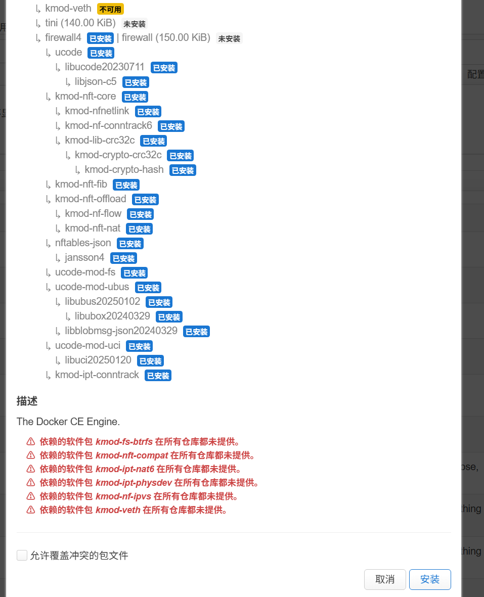

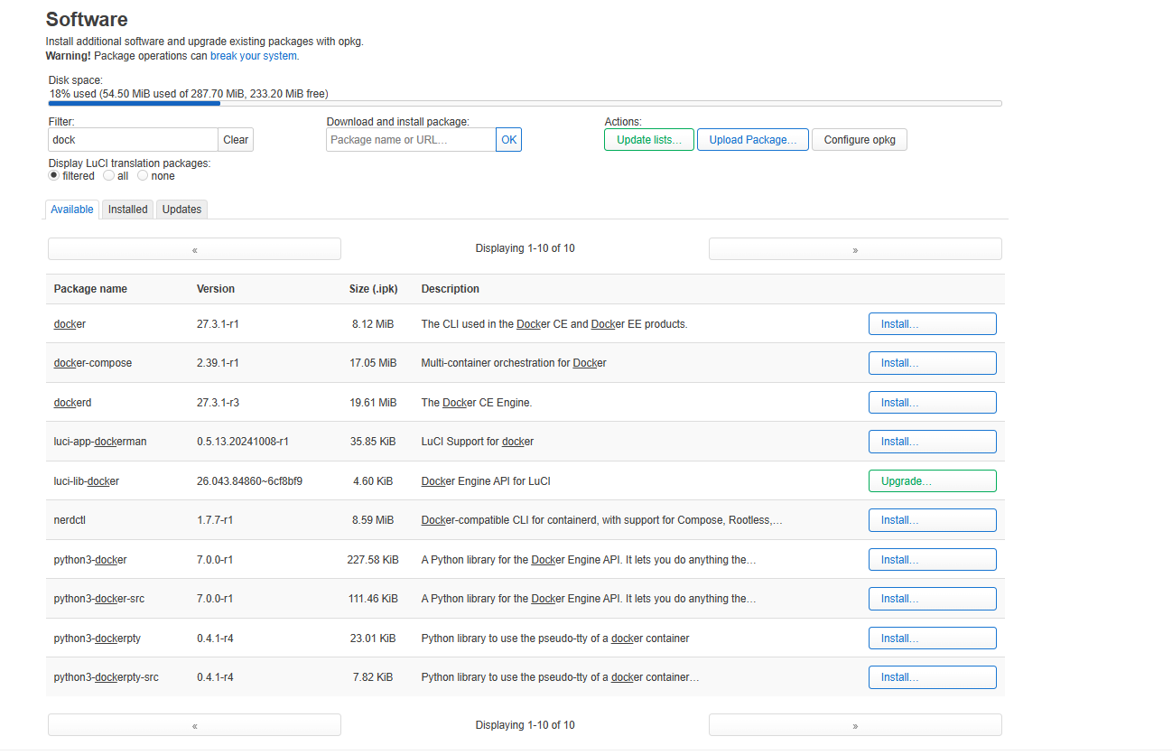

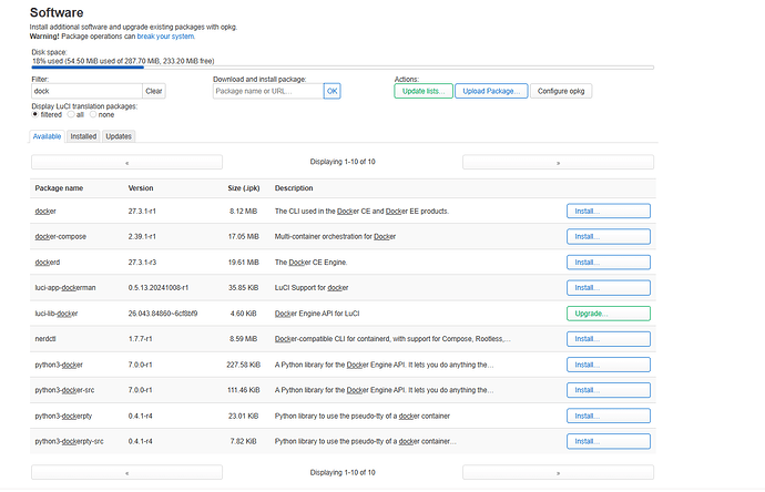

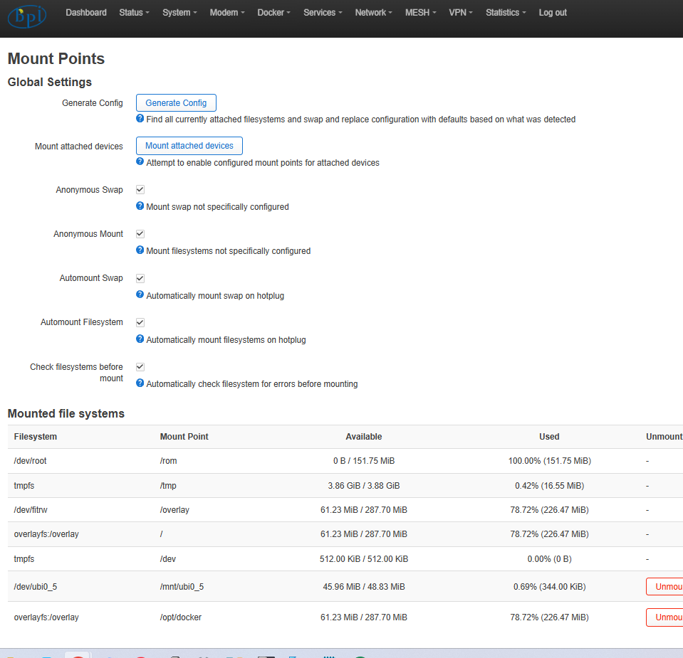

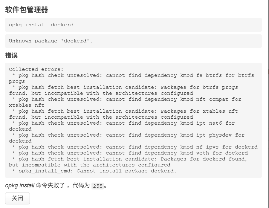

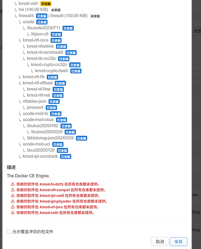

From software you can install complete Docker. I’m leaving you all the packages it has. Also in my repository you have the patch I created for all these XGS-PON including the official Banana Pi one that they sell:

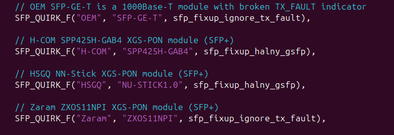

Code

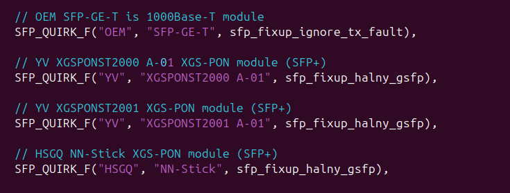

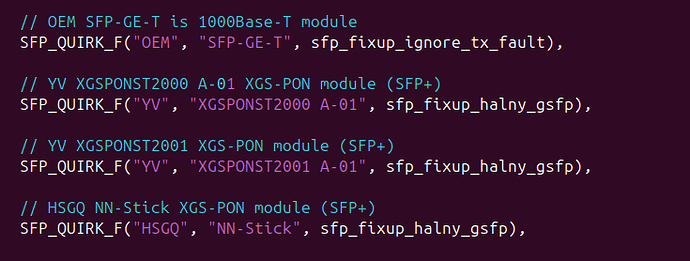

// H-COM SPP425H-GAB4 XGS-PON module (SFP+)
SFP_QUIRK_F("H-COM", "SPP425H-GAB4", sfp_fixup_halny_gsfp),
// Zaram ZXOS11NPI XGS-PON module (SFP+)
SFP_QUIRK_F("Zaram", "ZXOS11NPI", sfp_fixup_ignore_tx_fault),
// HSGQ NU-STICK1.0 XGS-PON module (SFP+)
SFP_QUIRK_F("HSGQ", "NU-STICK1.0", sfp_fixup_halny_gsfp),
// YV XGSPONST2000 A-01 XGS-PON module (SFP+)
SFP_QUIRK_F("YV", "XGSPONST2000 A-01", sfp_fixup_halny_gsfp),
// YV XGSPONST2001 XGS-PON module (SFP+)
SFP_QUIRK_F("YV", "XGSPONST2001 A-01", sfp_fixup_halny_gsfp),
// HSGQ NN-Stick XGS-PON module (SFP+)
SFP_QUIRK_F("HSGQ", "NN-Stick", sfp_fixup_halny_gsfp),

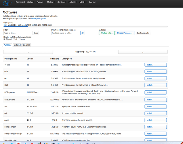

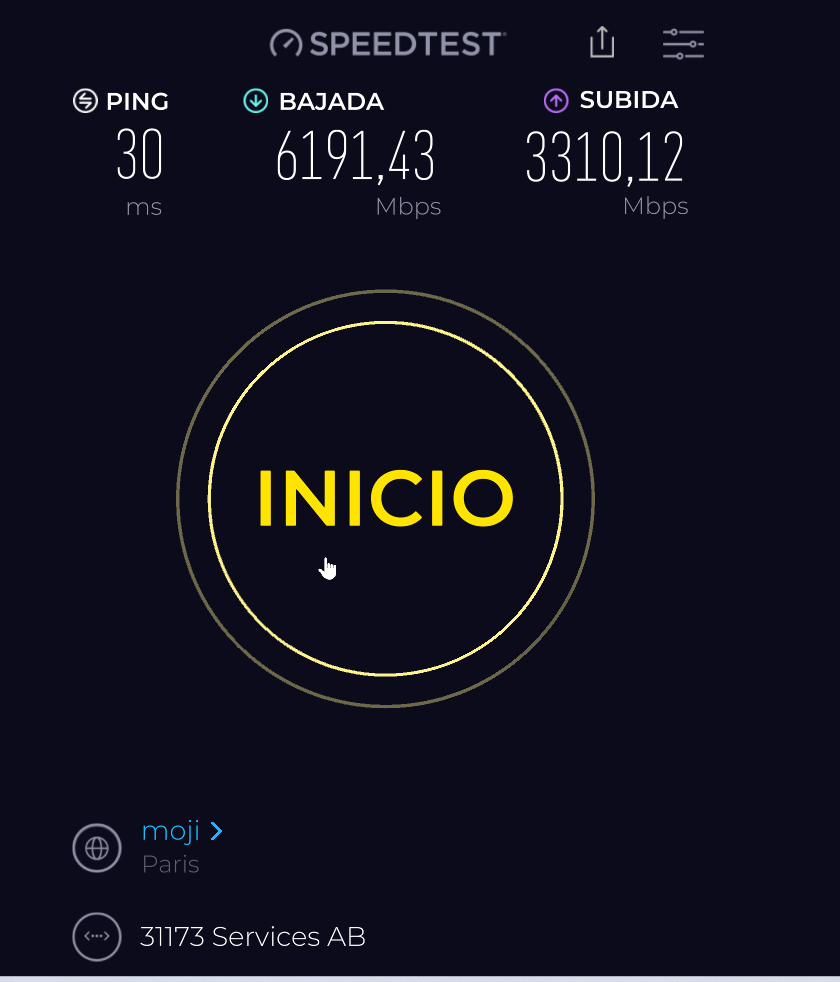

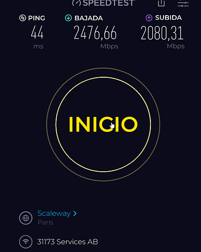

I’m leaving you some images to invite you to try it. If you need to see something, everything is in my repository: GitHub - brudalevante/BPI-R4PRO-8X-OPENWRT-V24.10.0-Master-Devel

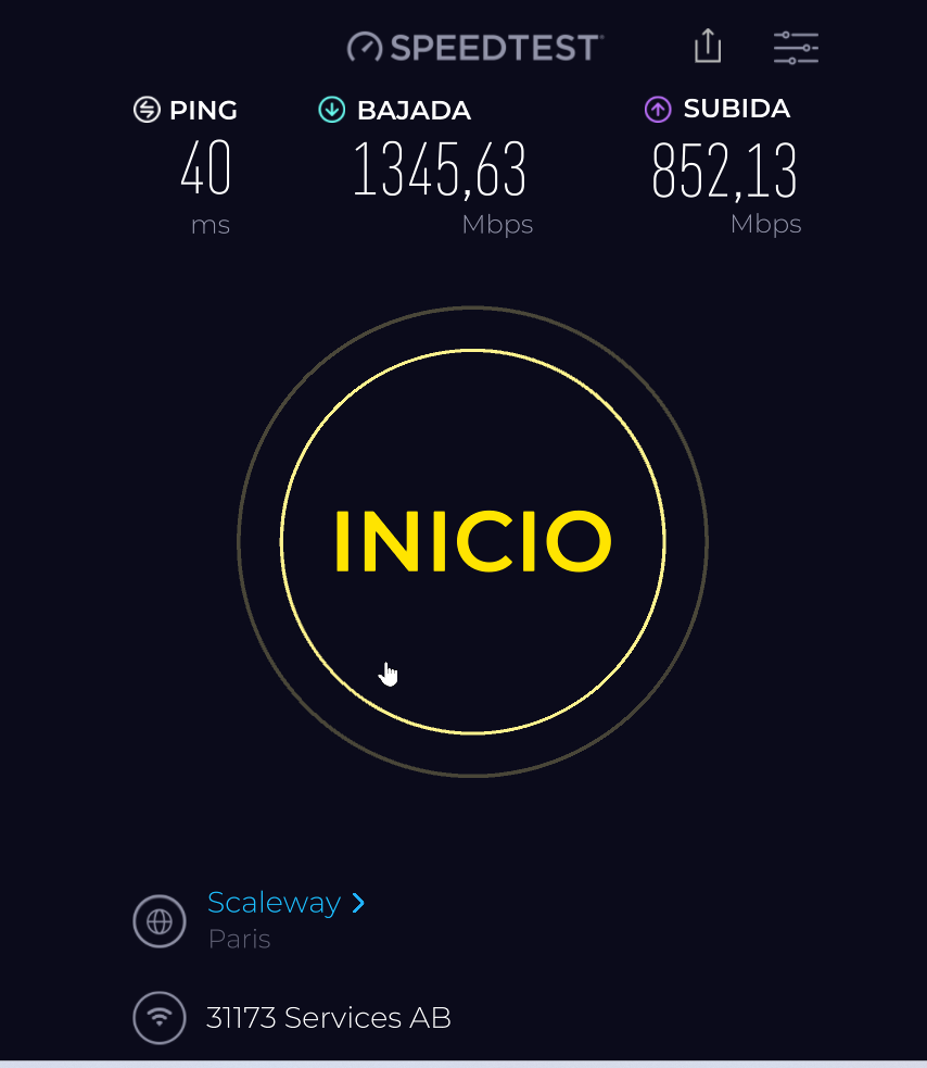

Captura de pantalla 2026-02-19 142931
Wireguard 1,500km from my house
WIFI 6G WIREGUARD
WIFI 5G WIREGUARD

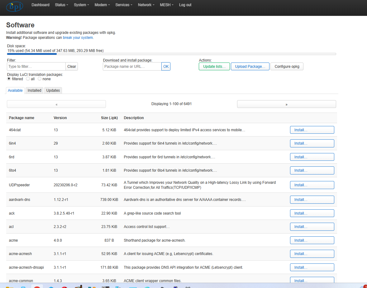

installed packages

Good afternoon, as I mentioned, my version works perfectly with my xgs-pon version was-110 -H-CON-SPP425H-GAB4. These ones shown in the photo were also added, including the official Banana Pi one. I don’t know if they will work for you, but mine does work since I don’t have the rest. The patch is included in the image you have posted, just like the one in my repository.
I’m including some photos and a sample of mine.
I have an image that automatically obtains the IP address at the same speed, but I haven’t uploaded it because I don’t need that much and it’s customized for me. If anyone needs it, just send me a private message; I’d be happy to share it. It’s very simple.
root@OpenWrt:~# i2cdump -y 2 0x50
No size specified (using byte-data access)
     0  1  2  3  4  5  6  7  8  9  a  b  c  d  e  f    0123456789abcdef
00: 03 04 07 10 00 00 00 00 00 00 00 06 67 00 00 00    ????.......?g...
10: 00 00 50 00 48 2d 43 4f 4d 20 20 20 20 20 20 20    ..P.H-COM
20: 20 20 20 20 00 00 00 00 53 50 50 34 32 35 48 2d        ....SPP425H-
30: 47 41 42 34 20 20 20 20 41 2d 30 31 04 f6 00 69    GAB4    A-01??.i
40: 00 00 00 00 50 54 32 35 34 37 31 30 42 30 30 30    ....PT254710B000
50: 39 38 20 20 32 35 31 31 31 39 20 20 68 f0 05 2a    98  251119  h??*
60: 00 00 00 00 00 00 00 00 c3 17 e3 93 cf 75 5a eb    ........?????uZ?
70: 5f 2a 66 00 00 00 00 00 00 00 00 00 b6 5e bf 43    _*f.........?^?C
80: 43 4d 55 49 41 53 57 43 41 41 33 30 2d 31 35 39    CMUIASWCAA30-159
90: 39 2d 30 31 56 30 31 20 02 fb 55 00 00 00 00 fd    9-01V01 ??U....?
a0: 00 00 00 00 00 00 00 00 00 00 00 00 00 00 00 00    ................
b0: 00 00 00 00 00 00 00 00 00 00 00 00 00 00 00 00    ................
c0: 53 46 50 2d 31 30 47 2d 54 2d 58 20 20 20 20 20    SFP-10G-T-X
d0: 20 20 20 20 30 38 a5 02 00 10 18 18 19 31 00 7d        08??.????1.}
e0: 38 34 38 39 31 20 42 30 20 4b 46 45 42 47 00 00    84891 B0 KFEBG..
f0: 00 00 00 00 00 00 00 00 00 00 00 00 00 00 00 ff    ................
root@OpenWrt:~# ethtool -m eth1
        Identifier                                : 0x03 (SFP)
        Extended identifier                       : 0x04 (GBIC/SFP defined by 2-wire interface ID)
        Connector                                 : 0x01 (SC)
        Transceiver codes                         : 0x20 0x00 0x00 0x00 0x00 0x00 0x00 0x00 0x00
        Transceiver type                          : 10G Ethernet: 10G Base-LR
        Encoding                                  : 0x03 (NRZ)
        BR, Nominal                               : 10000MBd
        Rate identifier                           : 0x00 (unspecified)
        Length (SMF,km)                           : 20km
        Length (SMF)                              : 20000m
        Length (50um)                             : 0m
        Length (62.5um)                           : 0m
        Length (Copper)                           : 0m
        Length (OM3)                              : 0m
        Laser wavelength                          : 1270nm
        Vendor name                               : H-COM
        Vendor OUI                                : 00:00:00
        Vendor PN                                 : SPP425H-GAB4
        Vendor rev                                : A-01
        Option values                             : 0x00 0x00
        BR margin, max                            : 0%
        BR margin, min                            : 0%
        Vendor SN                                 : PT254710B00098
        Date code                                 : 251119
        Optical diagnostics support               : Yes
        Laser bias current                        : 0.000 mA
        Laser output power                        : 0.0000 mW / -inf dBm
        Receiver signal average optical power     : 0.0000 mW / -inf dBm
        Module temperature                        : 34.00 degrees C / 93.20 degrees F
        Module voltage                            : 3.4174 V
        Alarm/warning flags implemented           : Yes
        Laser bias current high alarm             : Off
        Laser bias current low alarm              : On
        Laser bias current high warning           : Off
        Laser bias current low warning            : On
        Laser output power high alarm             : Off
        Laser output power low alarm              : On
        Laser output power high warning           : Off
        Laser output power low warning            : On
        Module temperature high alarm             : Off
        Module temperature low alarm              : Off
        Module temperature high warning           : Off
        Module temperature low warning            : Off
        Module voltage high alarm                 : Off
        Module voltage low alarm                  : Off
        Module voltage high warning               : Off
        Module voltage low warning                : Off
        Laser rx power high alarm                 : Off
        Laser rx power low alarm                  : On
        Laser rx power high warning               : Off
        Laser rx power low warning                : On
        Laser bias current high alarm threshold   : 60.000 mA
        Laser bias current low alarm threshold    : 0.000 mA
        Laser bias current high warning threshold : 55.000 mA
        Laser bias current low warning threshold  : 0.000 mA
        Laser output power high alarm threshold   : 6.5535 mW / 8.16 dBm
        Laser output power low alarm threshold    : 1.5848 mW / 2.00 dBm
        Laser output power high warning threshold : 6.5535 mW / 8.16 dBm
        Laser output power low warning threshold  : 1.9952 mW / 3.00 dBm
        Module temperature high alarm threshold   : 90.00 degrees C / 194.00 degrees F
        Module temperature low alarm threshold    : -50.00 degrees C / -58.00 degrees F
        Module temperature high warning threshold : 85.00 degrees C / 185.00 degrees F
        Module temperature low warning threshold  : -45.00 degrees C / -49.00 degrees F
        Module voltage high alarm threshold       : 3.6000 V
        Module voltage low alarm threshold        : 3.0000 V
        Module voltage high warning threshold     : 3.4700 V
        Module voltage low warning threshold      : 3.1300 V
        Laser rx power high alarm threshold       : 0.1995 mW / -7.00 dBm
        Laser rx power low alarm threshold        : 0.0011 mW / -29.59 dBm
        Laser rx power high warning threshold     : 0.1584 mW / -8.00 dBm
        Laser rx power low warning threshold      : 0.0014 mW / -28.54 dBm
root@OpenWrt:~# ethtool eth1
Settings for eth1:
        Supported ports: [ FIBRE ]
        Supported link modes:   10000baseLR/Full
        Supported pause frame use: Symmetric Receive-only
        Supports auto-negotiation: Yes
        Supported FEC modes: Not reported
        Advertised link modes:  10000baseLR/Full
        Advertised pause frame use: Symmetric Receive-only
        Advertised auto-negotiation: Yes
        Advertised FEC modes: Not reported
        Speed: 10000Mb/s
        Duplex: Full
        Auto-negotiation: on
        Port: FIBRE
        PHYAD: 0
        Transceiver: internal
        Current message level: 0x000000ff (255)
                               drv probe link timer ifdown ifup rx_err tx_err
        Link detected: yes
root@OpenWrt:~#
Good morning, I advise you to try this image, I hope you enjoy it. Automatic IP, XGS-PON patches - the usual ones posted in this same thread. You can also change country and set the desired power. All necessary kmods have been added so you can install 90% of the applications, such as Docker, containerd, mwan3, and a lot more for mobile.
record image on Sandisk 64GB micro SD
On the first boot, so you can install all the applications since you’ll have to do it through software, take an NVMe and format it in ext2, and mount it as overlay. In this case, I used a 128GB NVMe disk. I’m leaving you some images so you can see the mounting and the capacity I have to install - 115GB free, more than enough to install any application. First you must unmount the NVMe disk and then mount it by clicking the add button, as I show in the photo, and reboot. Then you’ll have the 115GB available.
You have Dawn and usteer enabled from the start. It’s recommended not to update it and leave it as it comes in the image.
since they are compiled with the corresponding version of fakemesh,
WiFi password: 12345678
SSID BANANA 2G BANANA 5G BANANA 6G
I’m leaving you some photos of both usteer already configured and Dawn. I’m also leaving you VPN speeds of 6G and 5G at 1,500 km from my house.
TEST 5G
TEST 6G
TEST SFP+WAN+SFP+LAN
