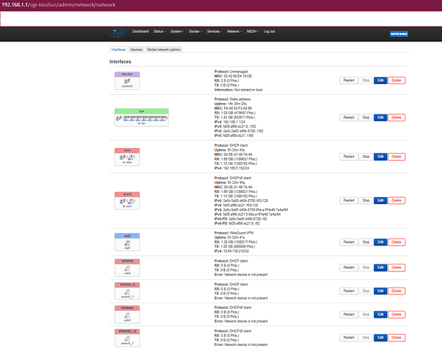

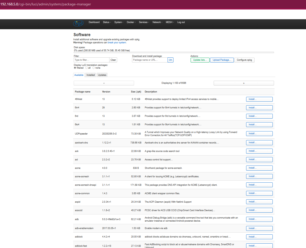

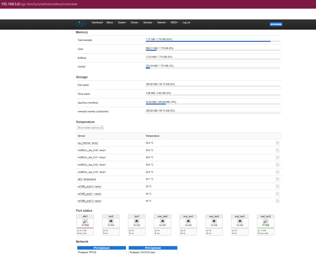

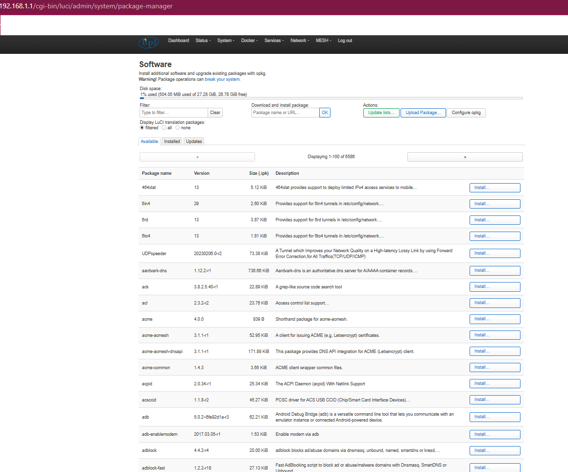

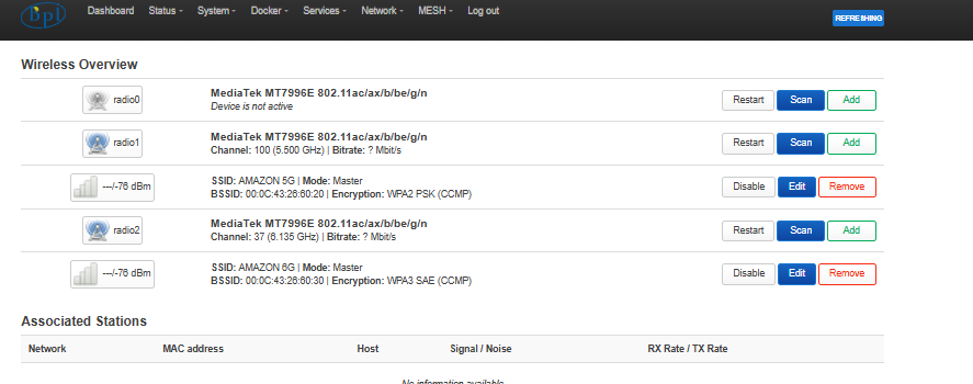

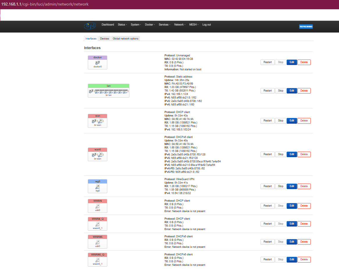

Good morning, @frank-w. I know perfectly well that thanks to you we have a version for the Banana Pi R4 with 4GB and 8GB of RAM in the same build, and I thank you for that. I know you’re also working with @andrewjlamarche to provide support for the Banana Pi Pro 8X.
Here you can see all my screenshots in this thread about this router, which has enormous potential. If we get the tools we requested, but the Banana team doesn’t respond, you can read all the previous threads where no one replies.
You have many images uploaded by me as requested by forum members via private messages.
Here is my repository with 120 commits. It’s a copy of the official repository, which hasn’t been updated in 7 months. I even bought the official version of xgs-pon, which includes the patch I added to my latest images to make it work.
my repository
my image
I’ve been compiling firmware for the Banana Pi R4 for two years, for both the 4GB and 8GB RAM versions. Previously, I worked extensively compiling OpenWRT-24 + MTK, but for the last year I’ve focused on the X-WRT fork.
OpenWrt forum username: bruda (On the OpenWrt forums, I only post/compile images for the Banana Pi BPI-R4 with 4GB and 8GB of RAM in this thread):
images banana pi r4 -4gb and 8gb ram
