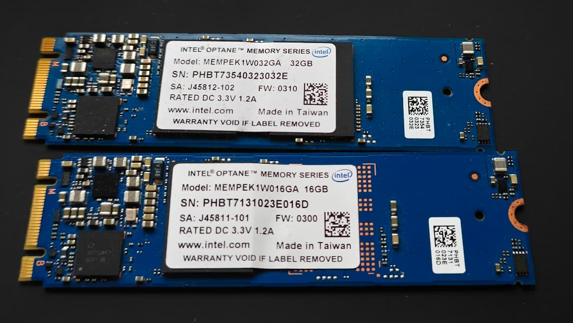

If anyone is interested I’ve found that Intel Optane 16 gig 2242 size M.2 works in the cellular modem slot in my new BPi-R4 (2.5 gig replace SFP+ model) because they are Key B + M style. Not a lot of storage but they can be had cheap (on FleaBay or AliE) from China - like 5 or 10 bucks delivered. Buy extras! I haven’t done actual testing on the BPi yet but since I had it pre-formatted ext4 it automounted at boot and shows properly in LuCI. Speedwise these normally write only about 150 MB/s but reads can max out a single PCIe lane at about 800 MB/s so good for boot drive stuff. Not especially energy efficient (they run hot) but are supposedly very durable. I’ve used them for a while in my TrueNAS servers with no issues so far!

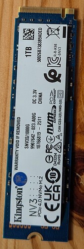

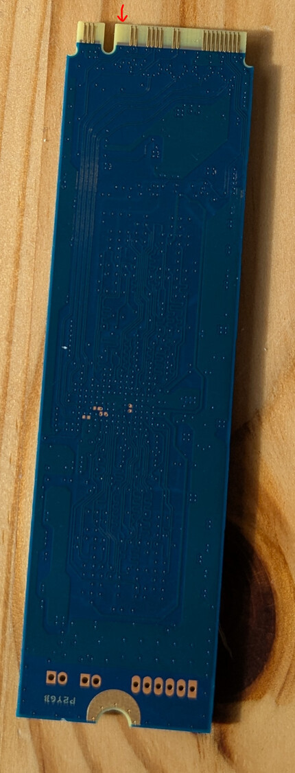

  • Kingston NV3 M.2 NVMe Gen 4 1TB (S/N: SNV3S/1000G)
  • Pins taped precautiously.
  • OpenWRT 24.10.2 - r28739-d9340319c6
It would be nice to add this and all other results of your tests to compatibility list, if possible. :slight_smile: Thanks for the information anyway
I tried this SSD in my banana pi R4 and it works

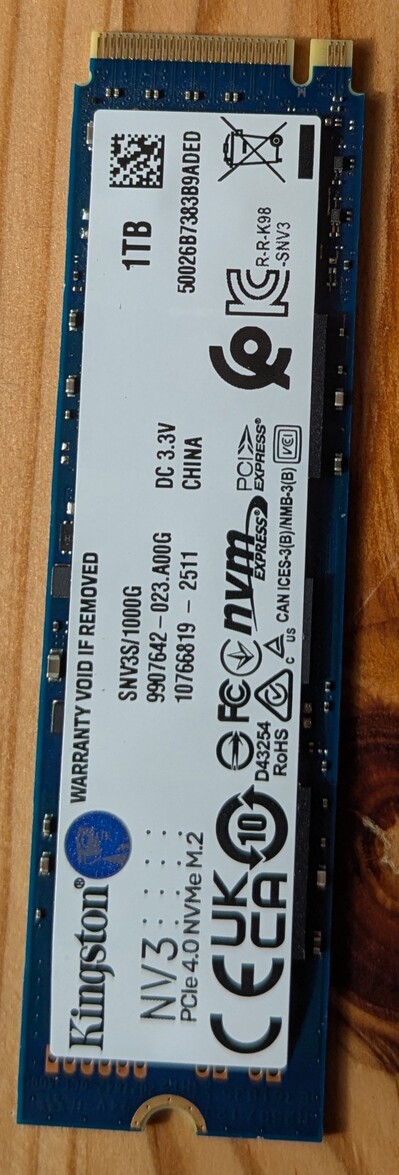

hey, I’m trying to set up a Kingston NV3 (1000 GB, M.2 2280) with the bpi-r4 poe 8gb soc (openwrt 25.12.0). Unfortunately it is not even listed by lspci. can you elaborate on how yoi got it working? thanks
edit:
Could you also elaborate on what you meant by this:
I found this post [BPI-R4] nvme+i2c, but the mentioned pins are not present on the ssd:
put optane 16gb and its works… after 2 days - no device, hmm died. Switched to 32gb and its works 10-12hrs and died too Take care, its abnormal 16GB is a new unused drive, 32GB has been used in TrueNAS as a boot pool for many months.
