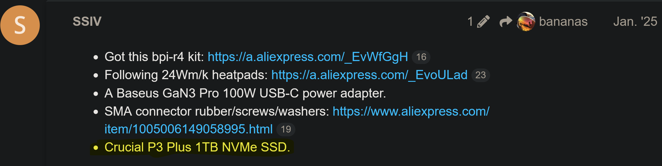

Crucial 1TB NVMe not recognized on BPI-R4 v1.1 with 8GB RAM
Continuing the discussion from [BPI-R4] nvme+i2c:
Thanks for your help @Lorem_amicus
I am running unmodified OpenWrt 25.12.5 (r33051-f5dae5ece4)
Do I need to flash Banana Pi’s OpenWrt fork?

Looks like it could be. It is a Crucial 2280, but maybe that is irrelevant.
