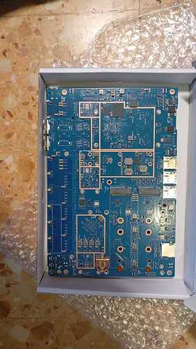

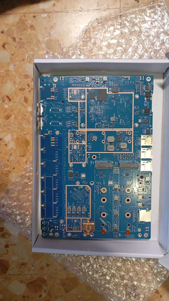

I see shielding areas on the back of the board, but there is no shielding.

Also, as colleague Marazm says, on the back of the board there are protective pieces — what are we supposed to do with them, eat them with potatoes? Or do you plan to put any accessory for them on sale?

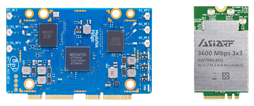

Did you see the BE14? There is no shielding installed (compared to AsiaRF, …):
It could be that heatsinks (especially on the BPI-R4 Pro) will have some shielding effect, but I’m not sure. The release of the BE14 was accompanied by some hardware bugs.

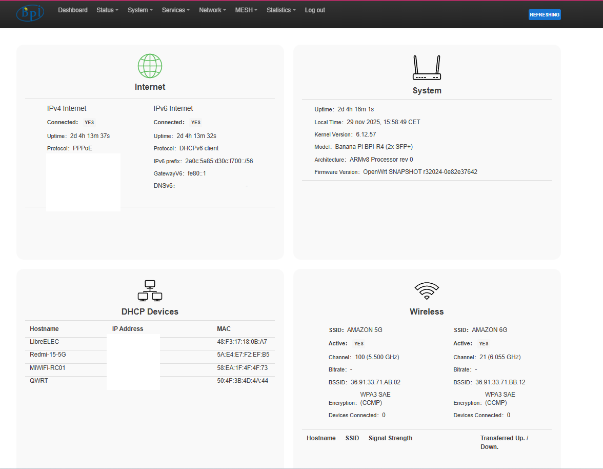

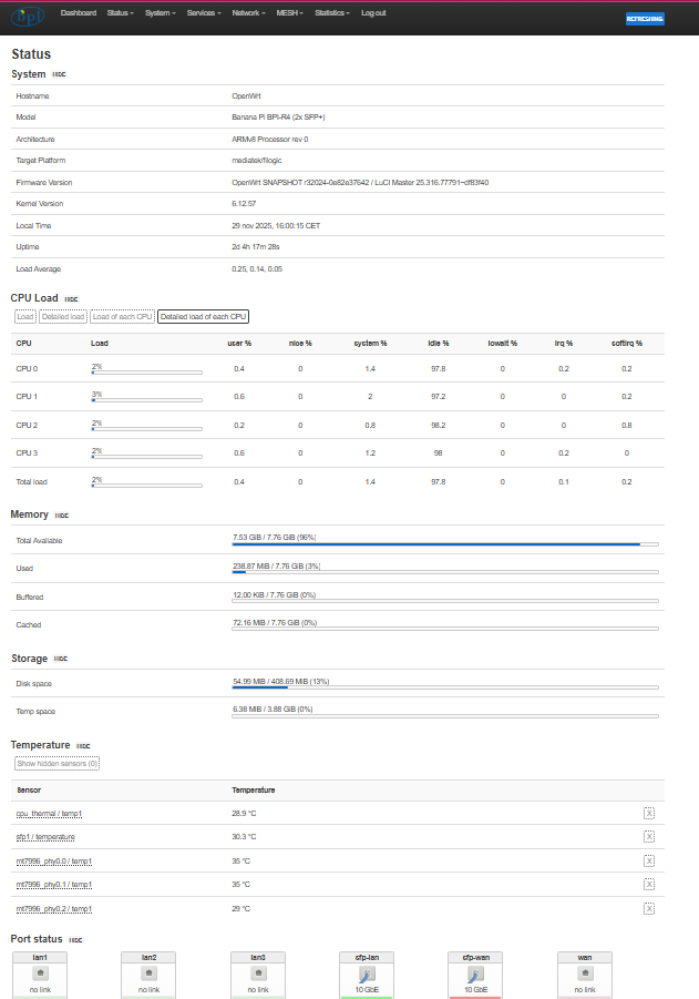

I invite you to look at the temperatures of my main case — Banana Pi R4 8 GB RAM. The image is mine and I even put the Banana Pi logo as a nod, but I can assure you the image is not from the Banana team and neither is the case: everything was made by me, including the patches, which are included in the image. They did not come from this official forum; I had to make them myself.
If anyone from the Banana team has temperatures or work like this, I invite them to publish it.
