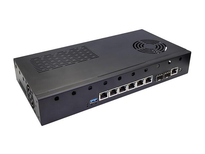

BPI-R4 Pro Case design
Banana Pi BPI-R4 Pro, it is easy to do a Wifi7 Router and Gateway. which project are you want to do???

good to see that are now fan- and ventilation holes there :slight_smile: maybe add similar to “normal” R4 case too (not that much but at least 1)?
And the option to use the BE14 wifi7 extender in a new case for the ‘normal’ R4, so the BE14 can be mounted separately on the side, cooled better and hopefully get less interference and noise.
What are the dimensions?
please allow* the people to replace the FAN to something really good like noctua. i dont care if a FAN costs 20$, when it does what it should (silent cooling) and i am willing to spend some more bucks to get that.
*) which means for me: using standard sizes and connectors

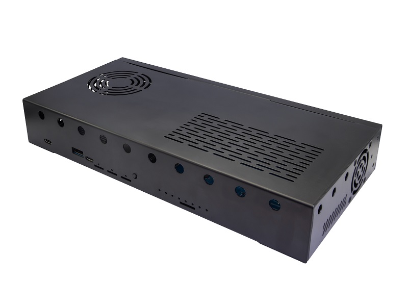

Few people will use all these holes for the antennas. Can you somehow design these to only be opened (punched out?) when needed. Or maybe have some sort metal stripe to cover those across the front and/or rear.
Supply brackets to rackmount it.
How about an internal DC power supply to power the unit directly from an AC input.
Is there any reason why fan-hole on top has no mounting holes for screws holding the 80mm (?) fan?
I’m seeing there is a trend with half (10-inch) rack compatibility. Me personally would be thrilled if you guys could design a case for it. So, I could bring R4 Pro into my transportable network mini rack.

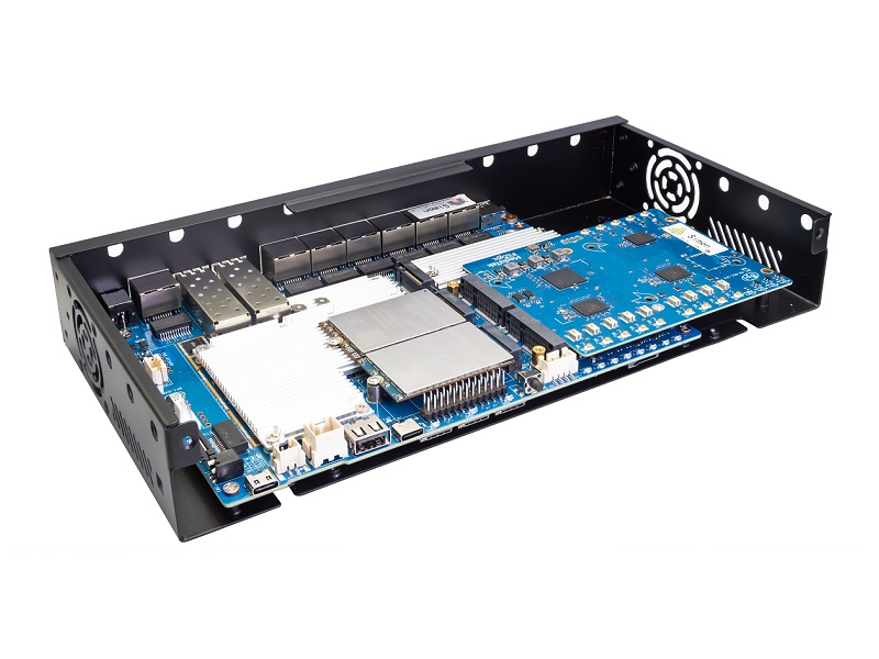

I see an issue here, the PHYs are not covered with the heatsink, they usualy produce ~3 watt of heat per 10gbase-T port, and without proper cooling they probably will be dead in a month
It will be better to distribute the board with phy heatsinks attached tho, users usually are not aware of 10GBASE-T problems
Yes, the heat sinks will be installed before shipment, including the 2.5G Switch as well.
  1. Can you confirm that heatsink will not conflict with m.2 cards?
  2. Heatsink allow to install fan on it, or it for fanless install?
  3. I wonder with installed BPI-R4-NIC-BE14 WiFi7 module, will the antena wires long enough to reach the mount places on case
  4. How soon case will be available for order?

Hi,
  1. The three M.2 slots at the top are for the 4G/5G cellular module, not for the NVMe SSD, most people will only use one. There is a 0.5mm gap between the heatsink and the module, but still, it is recommended to prioritize the one closer to the 26-pin GPIO pin, because the MT7988 + two 10G PHYs generate a lot of heat. This will keep the 4G/5G module slightly further away.
  2. Depending on your usage, if it’s light use, you don’t need a fan, although the heatsink will get a bit hot. However, if you’re using an R4 Pro + BE14 + two 10GHz PHYs, I strongly recommend adding a fan; this will significantly reduce the temperature.
Choose a fan mounting location you prefer.
  1. The casing has a total of 26 SMA antenna mounting holes, allowing you to install the antenna in any location you prefer; the length is sufficient, except for the furthest holes. If you absolutely need to use the furthest holes, you can use a longer coaxial cable.
  2. Our BPI-R4Pro is currently being tested, and the casing is also in production. It will be available for sale as soon as it’s finished (I also hope that the casing can be sold together with the motherboard :grinning:).
