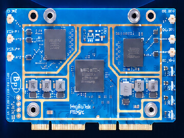

Banana Pi BPI-R4-NIC-BE14 V2.1 Wifi module

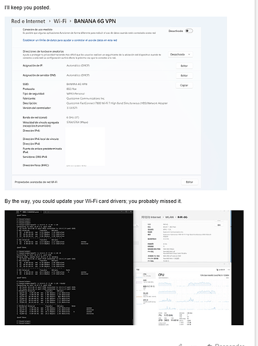

As soon as I have it, I’ll do a review. My son, the IT guy, has the same card and his pc is two walls away from the main router, so we’ll test one in the main room where my computer is and another with two walls in between and see the real results.
I have a Xiaomi BE19000, and my son gets 2 gigabits from where the main router is in the house, with two walls in between, on the 6GHz band, so there won’t be any misleading information. I’ll include both routers and the measurements from both, since we both use the same Wi-Fi card, which is the same one our beloved leader @sinovoip uses. It’s just another toy I have in a long list.
I’ll keep you posted.
By the way, you could update your Wi-Fi card drivers; you probably missed it.

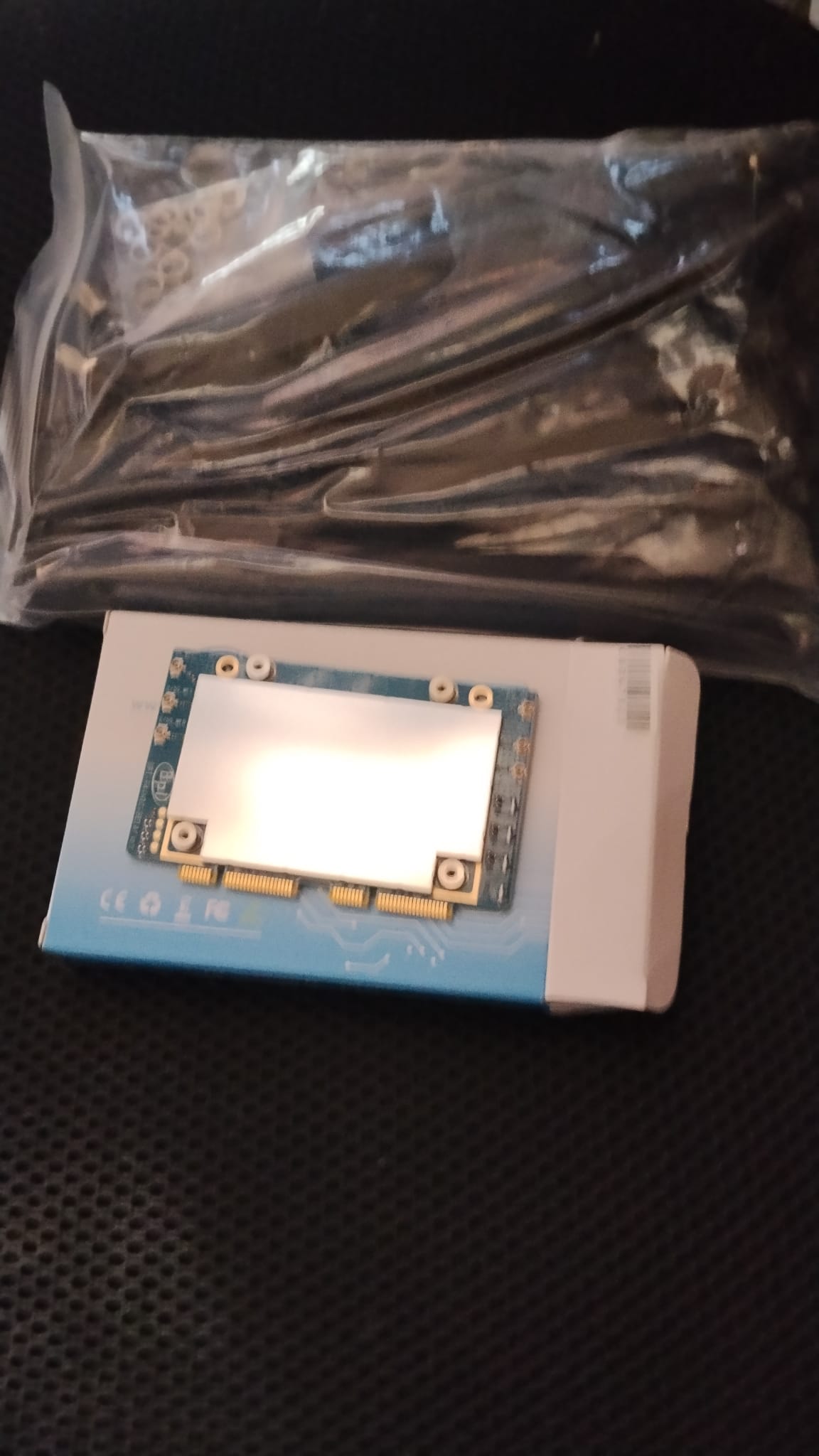

Good morning! What a pleasant surprise I had today! I just received the complete kit.
As soon as my family allows, since I’m the last one in the band, I’ll do what I promised.
Have a good day!

Your opinion is based on an understandable impression, but I believe the underlying assumption is incorrect:
Shielding starts at the PCB level and ends with the shielding cans; it does not start with them:
grafik
The old V1.1 design was completely different from the V2.1 design. It could not have been fixed simply by adding shielding cans, as Betonmischer demonstrated.
The visible separation of the different Wi-Fi chips is only one part of the overall design.
