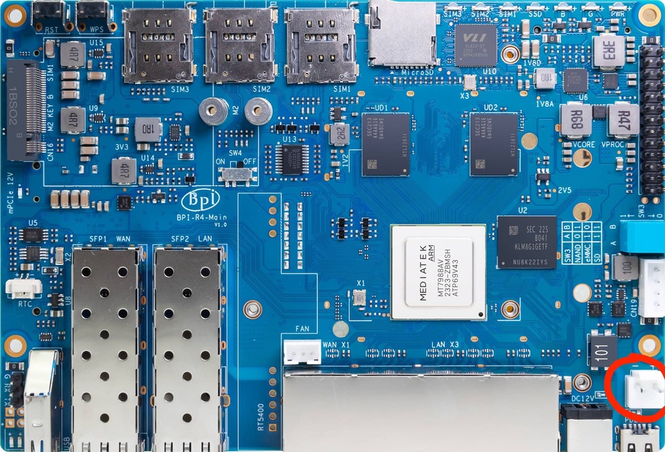

Thanks for the advice. I’ll try adding a ceramic 0.1 uF to the 3.3V line and see if it helps. Also to the 12V line after Q16 feeding the BE14 in parallel with C50 and C51, but I have yet to find a good spot to solder to.
Welp that’s sad to see it didn’t go well
How did you add the capacitors can I see that
This DC connector sits on the 12V line. I just looped the leads of the capacitors around the pins.
Ah ok, I use a usb c PSU to power my router
