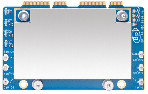

BPI-BE14 Wi-Fi7 NIC module -> first picture of the upcoming revised BE14
I’m not sure what I should tell you! :see_no_evil:
May be there is hope? :slightly_smiling_face:

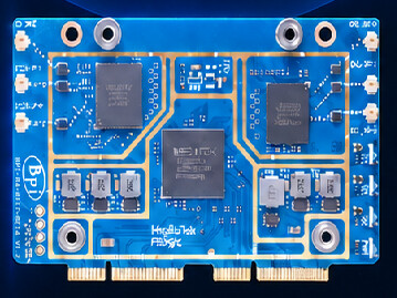

@simon @sinovoip Please consider taking back and replacing the bad modules buyers have received with the new and upcoming BE14 design.
I bought mine in March 2025 and it’s stuck with low TX power of 6 DBM at default which makes it useless to me.
Thank You!
There is NO visible SHIELD on the new BE14!
→ Maybe it will be added later, and maybe the board itself will have better noise performance / SNR…

As far as I know, a new version of BE14 will be released later. This picture is not the final version yet, the shield is being planned, please be patient.
Thanks! :+1:
What’s there to plan? WE NEED IT!)))
I am concerned as to why you are so eager to reply when you (by your own admission) do not have relevant information either.
I have three, I’d love to swap mine out. Or at least claim a credit card warranty process for my units when a new, proper, end-user, shielded, and production ready, version becomes available.
You’ll likely have to figure out what to do with the broken be14s yourself. Sinovoip, like banana in general, doesn’t take responsibility and won’t admit they’ve released junk. So, hoping for any help exchanging or returning faulty be14s is pointless. Personally, I bought an R4+be14 back in 2024, and even if they’d arranged to replace the old be14s with working ones, I still wouldn’t have been able to use it—the warranty had long since expired.

  • The price didn’t drop, and additionally the power consumption turned out to be 5.76 W at idle :neutral_face:

But there’s a reason why Banana Pi released a heatsink with a fan for BE14.

The new version requires verification of software and hardware functionality, as well as the size and effectiveness of the shielding layer. We have also added a hardware power meter to test actual transmit power. These steps will take time, so please be patient; the new version will be released some time from now.

I found a second picture:
77582207c3fbc5f04a17e92c8b35297e
grafik

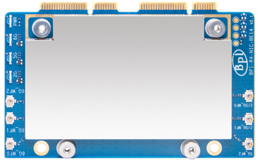

Is it out? :partying_face:
I did not believe to see this ever in my life :rofl::
V2.1 with cans/shielding :exploding_head:
It appears also on aliexpress:
https://a.aliexpress.com/_EwUbkgK (SinoVoip store)
https://a.aliexpress.com/_EzyHKTu (youyeetoo store)
I want one so much, but I won’t buy it till I see some test results. Hope it is good and this time we will get boards without so many problems.
