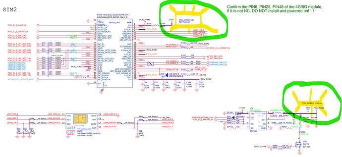

I was looking at the schematics of the R4 for both mini PCIe slots.
Did I see this correctly — that each PCIe slot can deliver a maximum of 3 A peak, but typically only 3.3 V @ 2 A?

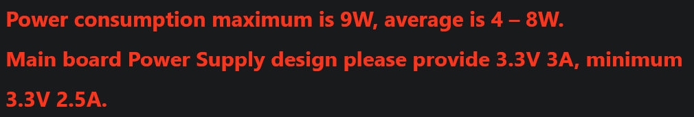

So the AW7916 (Wi-Fi 6E) with its rated 8 W (average ~5 W) works — but just barely. :pinching_hand:
→ It’s officially recommended to have 3.3 V @ 3–3.5 A.
But what about the AW7990, which requires up to 11.5 W?
→ That could already exceed the limits of the slot…
Maybe it’s possible to use it only for 2.4 or 5 GHz, and not both simultaneously? :see_no_evil:
Afaik maximum on 3v3 is 8A for all (including sfp)
This sounds good.
I was not sure what the ‘3A (peak 3A)’ stands for… is it what the R4 could deliver or what the wire could withstand?

This schematic is driving me crazy …

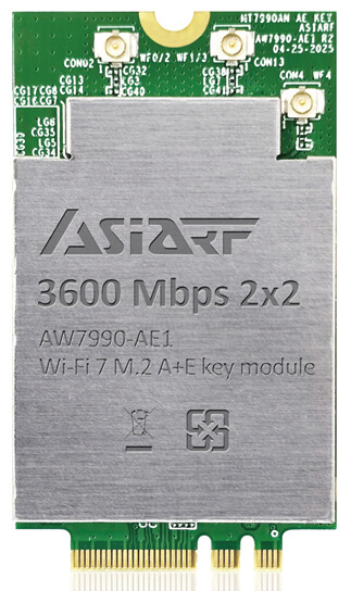

There is an A + E key variant from AsiaRF: AW7990-AED
The documentation looks identical to the AW7990-NPD.
The only thing I noticed is one additional IPEX port.

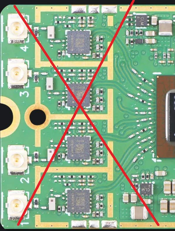

What I wasn’t able to understand:
→ It is just an iFEM module (now I do) :pensive:
→ There are no additional external amplifiers on the board:

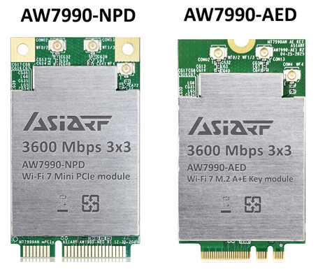

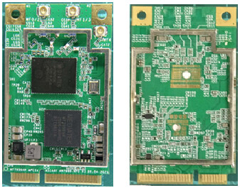

The recent developments regarding the AW7990:
  • Now both modules are equipped with 3× IPEX ports.
     grafik

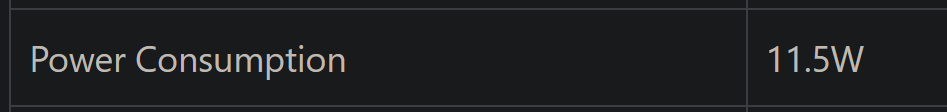

And there is a remarkable development regarding power consumption:
  • Sadly, the value in the table is unchanged:
But… an “interesting coincidence”:
  • The power consumption is the same as ASIARF’s AW7991-AE2 (BE5000).
For completeness, pictures without the cans:
grafik
