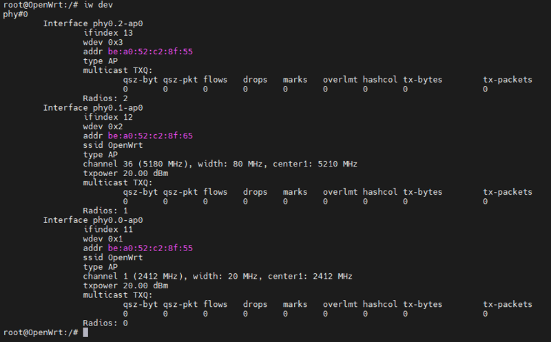

When using the OpenWRT mainline image with BPI-R4+BE14, the 2.4G/5G TX power was found to be low, only 6dBm and 7dBm respectively. The following is the solution:

  1. Go to the web page and turn on WiFi. Then use the iw dev command to see that the WiFi speed is now 20dBm.
