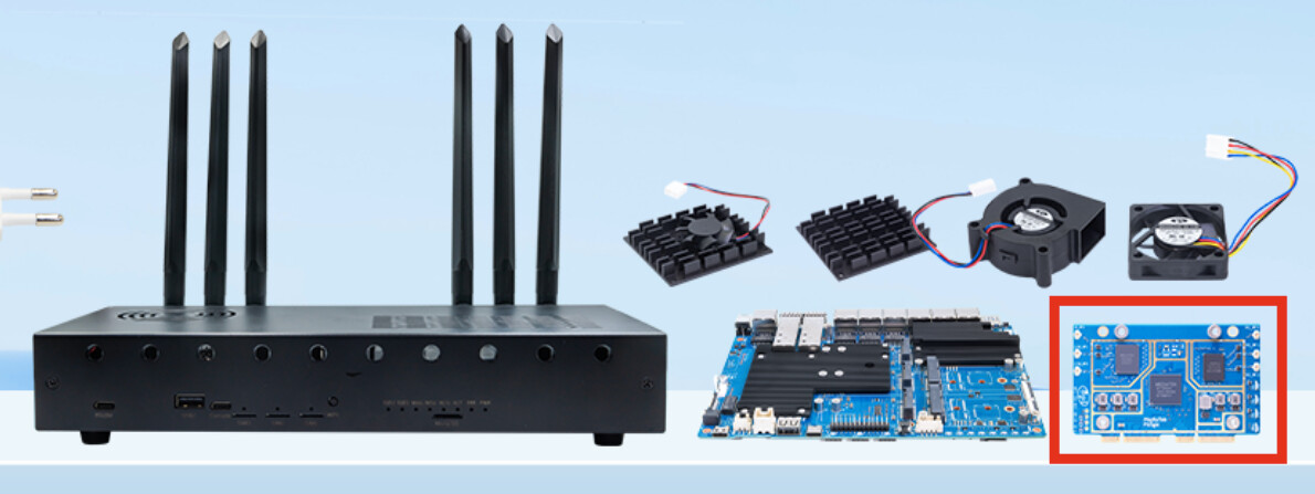

BPI-BE14 Wi-Fi7 NIC module -> first picture of the upcoming revised BE14
I found something interesting on:
https://www.bpi-shop.com
Looks like the first photo of an upcoming BE14 revision:
grafik

I hope they come with the correct EEPROM, because they are selling them with empty EEPROM, which makes them nothing more than a nice paperweight out of the box…
We added several extra steps to ensure the EEPROM was written correctly:
including rereading the actual written EEPROM and comparing it with the target value, reading the power configuration in software after installing each BE14 onto R4, and adding a hardware power meter to test the actual output power.

I mean the issues with range due to a lack of isolation on the PA on the old WiFi cards which the new WiFi cards fix, showing its a hw issue

The problem is though they’ve admitted that there’s an issue with the board, it’s not the speed that’s affected rather the range, due to a design flaw they didn’t consider in which was constantly denied till recently, while I wasnt expecting a fully polished software but I was expecting a board that would work to basic standards and expectations, I could understand minor hardware bugs but this is not minor at all

Take a look at this board:
The Wi-Fi chips aren’t even shielded from each other. A qualified electronics engineer wouldn’t make this kind of mistake.
This is what a Wi-Fi board should look like (example: BE19000):

It very much is a design flaw, as they didn’t even isolate the power amplifiers, whether it was intentional or not is a completely different, everyone isolates the power amplifier but they didn’t, if it weren’t a design flaw why go back and make a new BE14 then?

I am having issues with the BE14 module having excessively high noise values. This is significantly affecting the range. If the new board revision mitigates the noise issue, can I get my current BE14 module replaced? I purchased the module under the understanding that it would be functional.

Can you provide a link to this new be14? I can’t find this new card on the store’s website.
Is this new revision also “for developers”? Will this card be sold as a consumer device?

  • The new BE14 is confirmed, and you can see pictures in the store (was a mistake).
  • But it’s not released yet, and there isn’t any more information.
But again:
There isn’t even a shield on the new module :roll_eyes:!
And I’m not sure it ever will have one… time will tell.
