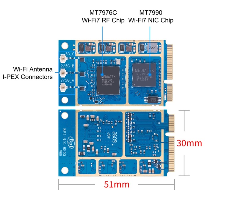

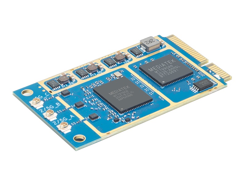

Would you mind to share the specs ? slightly confused by the 3 wifi antenna/i-pex connectors and two wifi chips…
when are you planning to release ?
? I assume it is the same as AsiaRF:
2.4 GHz 2T2R
5 GHz 3T3R
But if you compare it with AsiaRF, it looks far more advanced:
grafik
Their shielding compartments look as advanced as those on the new BE14 and BE19.
However, I would prefer a bit more metal around the corner mounting holes:
→ on upside AND downside
Yes, this size can only use MT7990 + MT7976C, iPA solution.
2.4 GHz 2T2R;5 GHz 3T3R
This is just an engineering sample now;
mass production will include shielding on both top and bottom.
