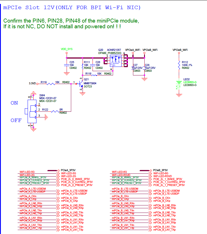

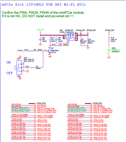

On Sinovoip boards the WiFi NIC 12V power is controlled by a physical slide switch (SW4, MSK-12C01-07). There is no GPIO connected to that rail.
The MTK patch uses devm_gpiod_get_optional — if no wifi-reset-gpios is in the DTS, it returns NULL and the reset block is skipped entirely. You could add the DTS property, but without the physical connection on the PCB it does nothing.
The fix on the RFB board required one extra wire from GPIO 7 to the WiFi 12V control line. On the RFB schematic, GPIO 7 (mt7988a_gpio7) is routed to the NIC reset. On BPI-R4 Pro 8X, the schematic shows SW4 in parallel with nothing — no GPIO pad.

On BPI-R4 Pro 8X: use the SW4 slide switch to cut 12V to the WiFi NIC, wait 2 seconds, switch back. On BPI-R4: full power cycle.
