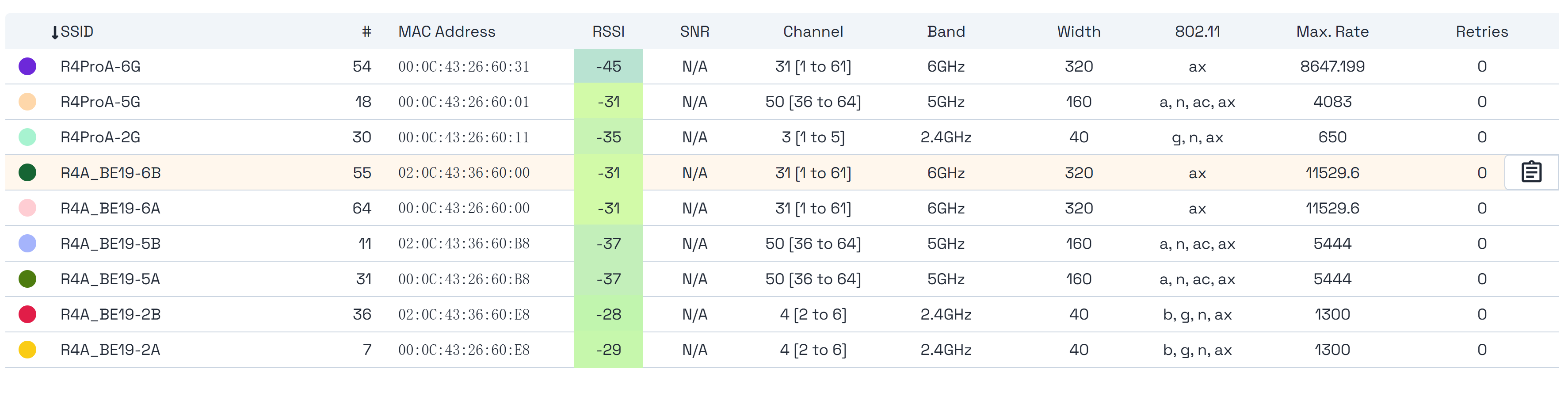

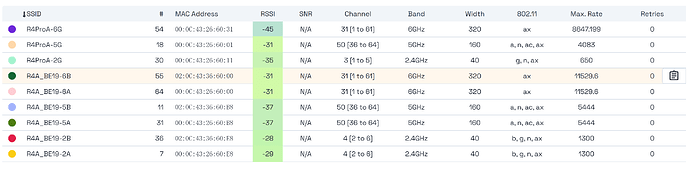

be1900 RF test :
we have finished all hardware function test . The RSSI value of BE19 looks very good now. Next, it’s time to perform calibration and install a shielding case + heat sink.
Would you mind sharing the noise figures for clients connected to the BE19 as seen on the BE19 end? That was the root cause of range issues with the BE14.
Good to know the BE19 is getting EMI shielding!
@sinovoip RSSI without SNR values says nothing. If the clients are next to the router, the signal strength will be high, so the RSSI will be high, even when then SNR is also high.
Can you supply the SNR values and possibly also the distance between the client and router?
can you maybe share some kind of roadmap. like, when exactly is calibration planned to begin and to finish? when is shielding case + heat sink expected? when is the first sale expected etc.?
Good evening @sinovoip bpi team leader, it also doesn’t show the WiFi 7 6G functionality.
At 320 Mbps, it clearly shows AX and not BE.
I see too many errors in that screenshot.
Regards
It’s a bit strange to show RSSI results without SNR and assuming there is no shielding on the card. And yes, why does AX show up when the value is 6G 320 MHz? It should be BE.

What has been shared so far is not sufficient evidence that BE19 fixes the problems people observed with BE14. A screenshot showing only RSSI does not validate range, stability, or RF quality.
  1. RSSI without SNR/noise is meaningless High RSSI at short distance can still happen with a poor link (high retries, errors, MCS drops). The BE14 “range” reports look more like a noise / isolation / EMI issue than a simple “TX power” issue. Without SNR / noise floor (or at least serious proxies like retries/failed under load), no conclusion can be drawn.
  2. Publish the minimum reproducible metrics (required) If you want the community to validate “BE19 fixes BE14”, you must provide at least:
Exact distance + obstacles (LOS / 1 wall / 2 walls; wall material: brick/concrete/drywall, etc.) Channel + bandwidth + TX power + regulatory domain/country (especially for 6 GHz) RSSI and SNR (or noise floor + RSSI) Actual PHY: Tx/Rx rates, MCS, NSS, EHT/HE mode, GI, retries, failed, packet error / loss Real throughput (iperf3 TCP and UDP) at 1 m / 5 m / 10 m / 1 wall / 2 walls Stability over time (30–60 min sustained load), temperature, and whether shielding/heatsink is installed Without these, results are anecdotal and not comparable.
  1. If you claim “6 GHz / 320 MHz”, why does it show AX instead of BE/EHT? That is a red flag. 6 GHz + 320 MHz is Wi‑Fi 7 (802.11be / EHT) territory. If the UI reports AX:
the client may not support EHT 320, EHT may not be enabled in driver/firmware/hostapd, the UI may be reporting incorrectly, or the test is not actually running at 320. Please clarify precisely:
whether EHT is enabled on the AP (driver + hostapd configuration), which client is used and whether it supports EHT 320 on 6 GHz, exact driver/firmware versions and the build tree used. 4) No “marketing screenshots”: we need repeatable results If there is no distance-based measurement table + the exact settings/logs/commands needed to reproduce it, then it is not evidence.
