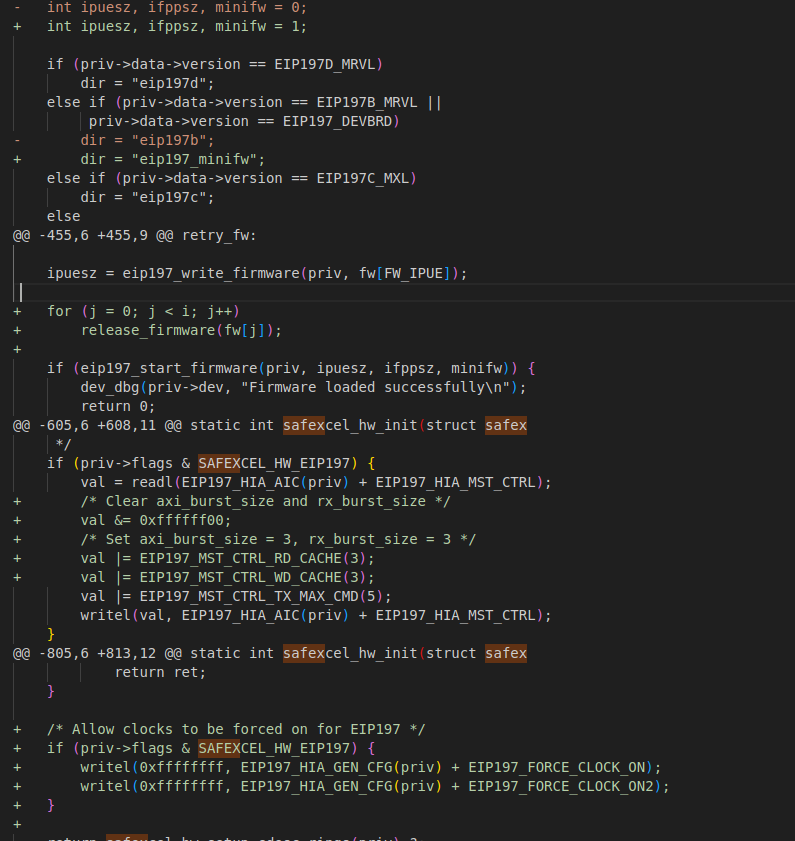

Can you please test these patches on 6.12 openwrt?
https://git01.mediatek.com/plugins/gitiles/openwrt/feeds/mtk-openwrt-feeds/+/8630c64a5f0f1c15a11b66e61a62a3d80f5aa197
I think these are the missing patches for 6.12. Good that MediaTek is watching.
MediaTek, pls fix for crypto-eip driver as well. When “look aside mode” is enabled, I only see one interrupt triggered on the ring queues, then the “openssl speed” hangs.
I see you commented “look aside mode” unstable in the patches, if you could confirm “inline mode” is working fine, then I’m okay. I’ve yet to setup strongSwan to test…so not sure if “inline mode” works or not.
I asked them :slight_smile:
Is you comment after that also related to the new patches? Then i have to give them the information back. Also dts node dies not follow binding and changes to driver may not be upstreamable.
Oh, great that you can quickly get their attention.
The patches you posted are about crypto-safexcel driver. They’ll work for sure. No doubt about it.
It’s about the crypto-eip driver that MediaTek provides separately to the public. Pls pass them my comment above. Thanks
This works as expected now on OpenWrt Snapshot kernel 6.12. Throughput for OpenSSL though is rather low as posted previously. Hence, the EIP197 is not of much use practically.

where have you applied this code? to 6.6/6.12 or 6.18?
tested last patches from mtk and got same result…
as i see firmware-load in your code i guess safexcel needs to be compiled as module and i need the firmware blob in rootfs (or of course both builtin).
in dts i see additional compatible (is this used?) and the link to eth node which imho is only for propritary hnat.
@moore is there any new state?
as you can read in my previous posting on 6.18 i still have not got it probed…maybe the firmware+corresponding patch is needed for it? it silently failes (no error in dmesg and no IRQs without debug)
yes @frank-w i just used the definitions in openwrt committed by daniel golle
in upstream openwrt i only see the patches 400 and 401, but nothing related to the mini firmware
maybe it is somewhere in generic patches? looked in pending-6.12 and hack-6.12, but see nothing related
rebased by 6.18-crypto tree (on 6.18-rc and dropped the reverted commits from 6.6) a bit to avoid confusion what i have added and what reverted
have now found and builtin the firmware, firmware-code was already in the 6.12 patch
but i still have version=0, no idea why
my current state:
