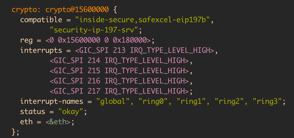

actually think I found the issue the openwrt snapshot dts doesn’t have compatible for ā€œsecurity-ip-197-srvā€
btw it does load now the ddk but not crypto-eip after the above change

here is my crypto config in mt7988a.dtsi
