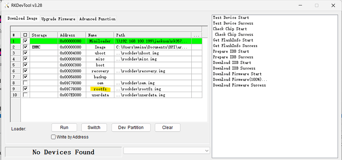

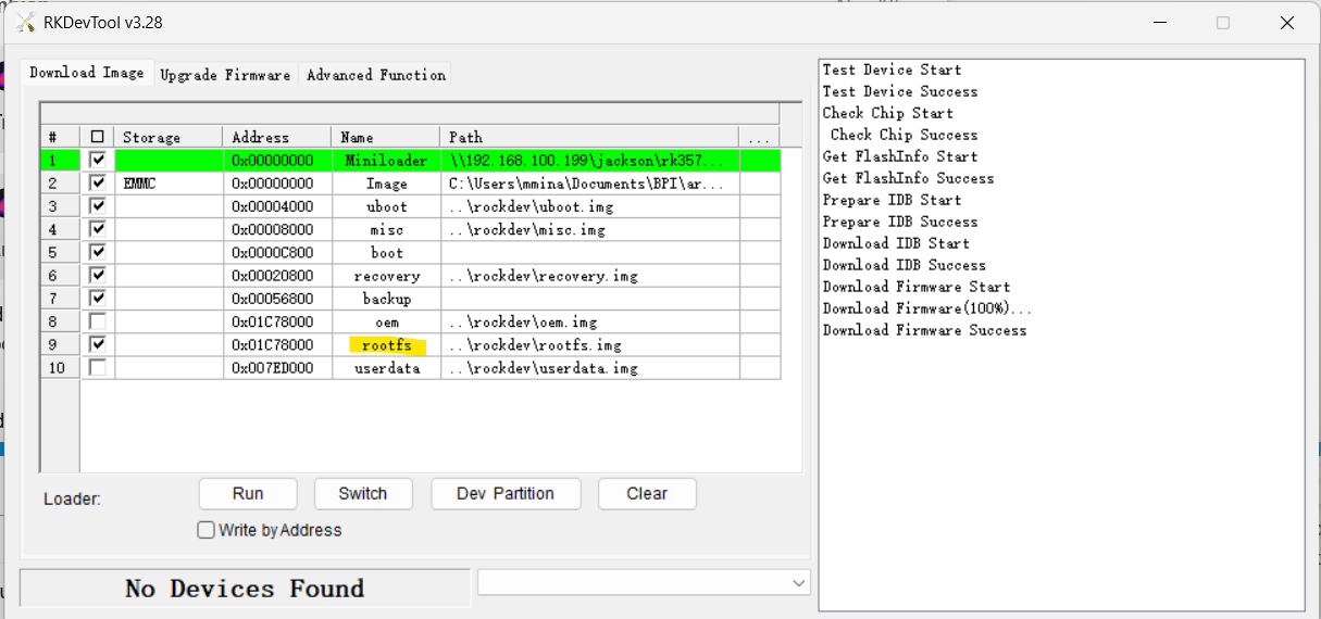

Task with BPI-P2 Pro was not easy. I used armsom-p2pro-bsp source for tailoring kernel5.10.110, debian Bullseye to open functionality for I2C, PWM ports. Wify, BT, Leds on/off, thermal_zone. Also swap file, used sdcard as external file system. I changed the logic of /boot file system which is now visible.
I compiled update.img file for loading RKDevTool image into eMMC
