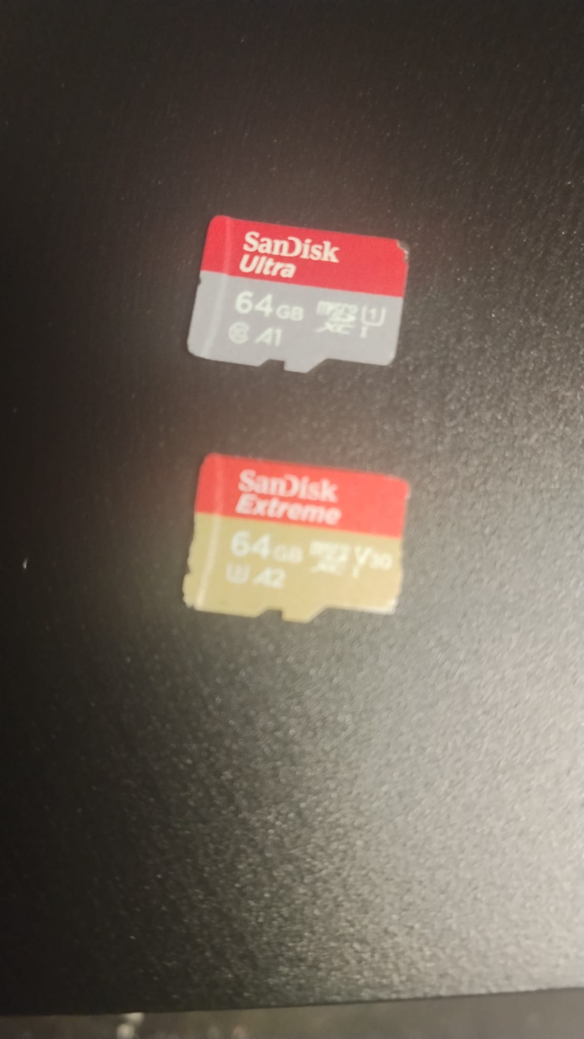

Hello, your problem is with the micro SD card. Please try the SanDisk 64GB card I mentioned. It doesn’t work for me with the same 32GB card; I have the same problem as you. I get the same result with a 128GB card from another brand.
It only works for me with this one. card
SanDisk-Extreme-64GB

Yes, you might want to try a different SD card.
Good morning. I advise against mounting the NVMe drive on an ext2 partition, as it can become corrupted after several boot cycles. Alternatively, I might have mounted it incorrectly, since I installed a 32GB SanDisk Extreme microSD card (which provides ample space) and formatted it as ext4. The problem might lie in the NVMe drive’s ext2 formatting, which is incorrect.
I’m leaving the complete boot process with a reboot, with everything installed on the new 32GB micro SD card.
