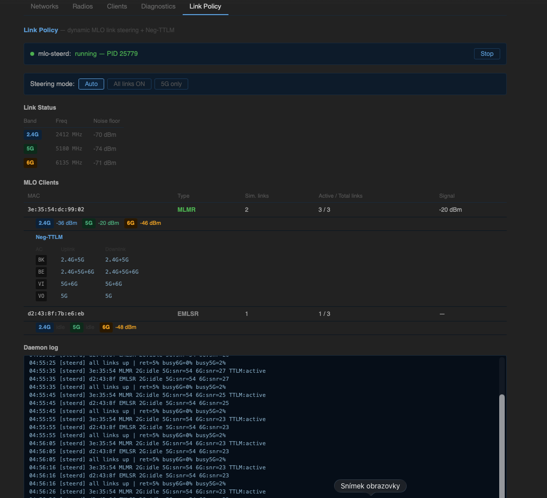

v3.0.0 — Link Policy tab: open-source MLO band steering + traffic steering
Following up on the earlier discussions about MLMR-STR capabilities and Neg-TTLM negotiation — we’ve now put both to practical use. v3.0.0 adds a Link Policy tab with a working MLO link steering daemon and a live control UI.
GitHub: GitHub - woziwrt/mt7996-wifi7-manager: WiFi 7 / MLO manager for BPI-R4 (MT7996) — LuCI package for OpenWrt with MTK SDK · GitHub
APK: Release v3.0.0 — Link Policy: MLO band steering + Neg-TTLM · woziwrt/mt7996-wifi7-manager · GitHub
Background
The MTK SDK hostapd already exposes the full API for dynamic link management — SET_ATTLM for AP-side link disable/enable, and negotiated_ttlm for TID-to-link mapping negotiation. We’ve been discussing these in earlier posts at the protocol level. mlo-steerd is a shell daemon that now sits on top of that API and makes real-time decisions.
The script lives at /root/mlo-steerd.sh on the AP router, autostarted via procd with respawn on crash. Source is in the bpi-r4-deploy repo, my_files/mlo-steerd.sh.
Algorithm 1 — Band steering (SET_ATTLM)
The daemon polls every 10 seconds and computes a weighted score per link:
score = SNR_normalized × 60%  +  (100 − tx_retries%) × 30%  +  (100 − channel_busy%) × 10%
SNR is normalized over a per-link soft zone ([SNR_HARD_LOW .. SNR_HARD_HIGH]), giving a 0–10000 integer. The decision table:
Condition Action
SNR < hard_low (2 dB for 6G, 0 dB for 5G) Immediate disable
SNR > hard_high AND retries < 15% Immediate enable
score < 4000 Disable
score > 6000 Enable
4000 ≤ score ≤ 6000 No change (hysteresis)
Priority order: 6G evaluated first, 5G only if 6G already disabled — client is never left with no link. 30-second cooldown between actions.
For EMLSR clients (iPhone, max_simul_links=1) this is the only mechanism — band steering via SET_ATTLM, no Neg-TTLM.
Algorithm 2 — Traffic steering (Neg-TTLM)
When all links are up and an MLMR client is connected (max_simul_links > 1, in our setup the BPI-R4 running as MLO STA), the daemon sends a negotiated_ttlm request mapping traffic classes to optimal bands:
AC TIDs Links Rationale
Background (BK) 1, 2 2.4G + 5G Bulk transfers — spare 6G for latency-sensitive
Best Effort (BE) 0, 3 All General traffic — full capacity
Video (VI) 4, 5 5G + 6G High throughput, low latency — skip 2.4G
Voice (VO) 6, 7 5G only Minimum latency — stable mid-band, no 6G range risk
Verified live on MT7996 (2026-05-27). The client accepts and routes accordingly:
hostapd_cli -i ap-mld-1 get_neg_ttlm 3e:35:54:dc:99:02
Link Mapping:   uplink  downlink
TID 0:          0x0007  0x0007   ← BE → all links
TID 1:          0x0003  0x0003   ← BK → 2.4G+5G
TID 2:          0x0003  0x0003
TID 3:          0x0007  0x0007
TID 4:          0x0006  0x0006   ← VI → 5G+6G
TID 5:          0x0006  0x0006
TID 6:          0x0002  0x0002   ← VO → 5G only
TID 7:          0x0002  0x0002
One implementation detail worth noting: SET_ATTLM and Neg-TTLM cannot be active simultaneously — issuing negotiated_ttlm request while A-TTLM is running returns “Busy: A-TTLM is on-going”. The daemon handles this correctly: before any SET_ATTLM call it tears down active Neg-TTLM mappings, and re-applies them when all links come back up.
Link Policy tab
The new tab (only shown when an MLO AP is configured):
Live view: MLMR client (BPI-R4 STA, 3/3 links, Neg-TTLM active) + EMLSR client (iPhone, 6G only)
  • Daemon control — start/stop, status dot + PID
  • Steering override — three buttons: Auto / All links ON / 5G only, written to UCI mlo-steerd.global.mode, picked up on next poll cycle without restart
  • Link status — live noise floor per band (iw survey)
  • MLO clients — EMLSR vs MLMR, per-link signal, active Neg-TTLM mapping per AC for MLMR clients
  • Daemon log — last 25 lines of /tmp/steerd.log
Install
scp luci-app-wifimgr-3.0.0-r20260528.apk [email protected]:/tmp/
ssh [email protected] 'apk add --allow-untrusted --no-network /tmp/luci-app-wifimgr-*.apk'
Requires OpenWrt with MTK SDK (kernel 6.12.x, mt76, MLO-capable hostapd).
The thresholds are currently hardcoded in the daemon script — the next logical step would be UCI-configurable values exposed in the UI. If anyone tests this in different RF environments or with other MLMR clients, would be interested to hear how the algorithm holds up.
