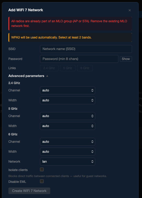

v2.0.0 prevents this entirely. All wizards now detect and block the configurations that trigger the crash before they are applied:
  • Adding a second AP to an MLO radio → blocked with an inline error
  • Adding an MLO AP when radios are already in another MLO group → blocked
  • Adding an MLO STA when a local MLO AP or another MLO STA is already active → blocked
  • WDS / Repeater uplink on a radio that is part of an MLO group → blocked
  • Applying an AP to an MLO radio → always triggers reboot instead of wifi reload, even if the UI guard is somehow bypassed

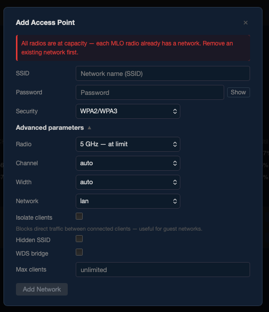

  • EDCCA crash prevention in wizardAP — Radios that are part of an MLO group and already have one legacy AP are disabled in the selector (“— at limit”) and show a blocking error.
  • EDCCA crash prevention in wizardMLO — Link toggle buttons for radios already in an existing MLO group are disabled.
  • MLO radio always reboots — wizard_ap() detects if the target radio is part of an MLO group and triggers a reboot instead of wifi reload, eliminating the risk of EDCCA crash even if the UI guard is bypassed.

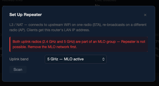

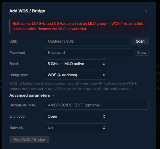

  • MLO conflict blocking in wizardWDS / wizardRepeater — Radios that are part of any MLO group (AP or STA) are disabled as uplink options.

Safety blocks — wizards actively prevent incompatible configurations:
Station Wizard MLO Wizard blocked AP Wizard blocked
wizardStation wizardMLO blocked wizardAP blocked
WDS / Bridge blocked Repeater blocked
wizardWDS blocked wizardRepeater blocked
