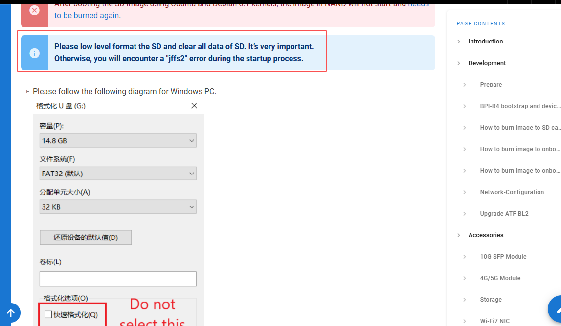

I found this passage on the “Getting Started” section of the official website.
I think it might be due to the SD card not being fully formatted. It might be necessary to perform a low-level formatting to avoid the jffs issue.
This is true. I’ve never had to zero out an SD card before flashing a mainline OpenWrt image, but the Sinovoip fork will indeed break on a dirty SD.
