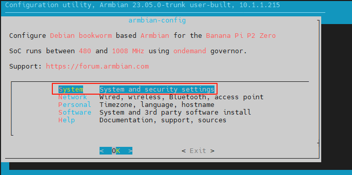

Enter “armbian-config” to enter the configuration settings.
Select the “System” option.

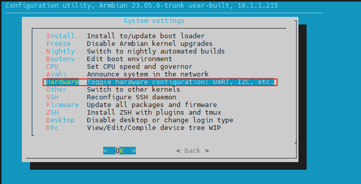

Select the “Hardware” option

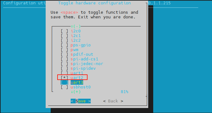

Select the configuration to be enabled by using the spaces.
Restart

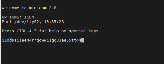

Second verification
Connect the Uart2 together and use minicom for verification.
As can be seen from the figure, when you send a byte, the system will automatically output the same byte.
