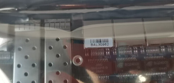

Hello, you can distinguish whether your R4Pro board is from November 2025 or December 2025 by the labels on the board. If the letters “BAL” at the beginning of the photo above refer to December 2025, then those with the letters “BAK” at the beginning refer to November 2025.
Ok, i’ve got a BAL. And the Boards with BAL have already the OpenWERT Image from 291225?
Greetings Alex
It can be confirmed that the board in your hand is already in the 251229 mirror image state when it was manufactured.
ok, thank you for the info.
