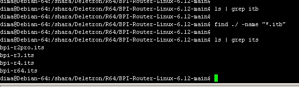

i don’t have the created file “bpi-r64.itb”
itb
how do i create this “itb” file ?

nothing
i don’t have creaated bpi-r64.itb

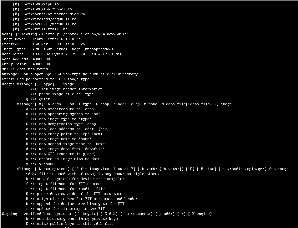

i have done:
$ git clone --single-branch --branch 6.18-rc https://github.com/frank-w/BPI-Router-Linux
$ cd BPI-Router-Linux
$ nano build.conf
$ ./build.sh importconfig
$ ./build.sh config
$ ./build.sh
$ cd ../
$ find ./ -name "*.itb"
nothing
cat build.log

strange…have you u-boot-tools installed for mkimage (can you call this command)? possibly an error there is not added to build.log. but build.sh should check for u-boot-tools too and exit when it is not there before building.

sh: 1: dtc: not found
something is missing in my system…
mb device-tree-compiler ?
YES
apt install device-tree-compiler
:slight_smile: )
Thanks, friends!
