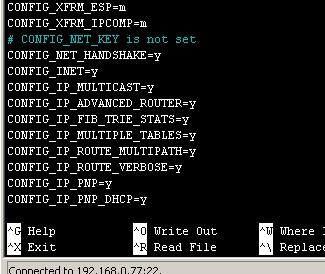

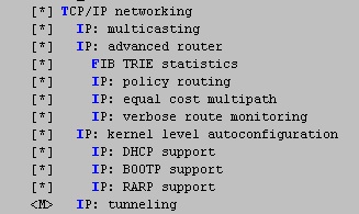

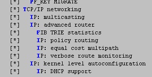

i somehow managed to compile a kernel with policy routing support
CONFIG_IP_ADVANCED_ROUTER=y
CONFIG_IP_FIB_TRIE_STATS=y
CONFIG_IP_MULTIPLE_TABLES=y
CONFIG_IP_ROUTE_MULTIPATH=y
but i still can’t use this feature.

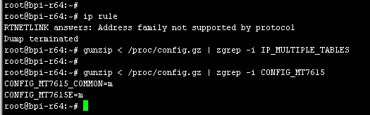

root@bpi-r64:/# ip -4 rule
RTNETLINK answers: Address family not supported by protocol
Dump terminated
root@bpi-r64:/# ip -6 rule
0:	from all lookup local
32766:	from all lookup main
root@bpi-r64:/# ip -V ip utility, iproute2
ip utility, iproute2-6.1.0, libbpf 1.1.2

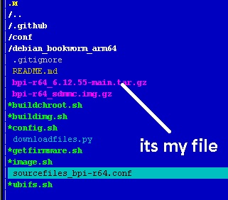

yes i see builcore
i uploaded my file but i also later loaded my kernel onto the SD card buildimg
I’m not sure that it is really your kernel you have booted.
Check with “uname -a” and “zgrep -i ‘IP_MULTIPLE_TABLES’ /proc/config.gz”
In case you have builtin these options it is enough to copy bpi-r4.itb to BPI-BOOT partition. If you use install option of kernel-repo build.sh maybe filename has to be adjusted in uEnv.txt.
just type
    gunzip < /proc/config.gz > config.current
on your booted kernel and check if it’s what you expect
indeed
there’s no ‘IP_MULTIPLE_TABLES’ option here,
why didn’t it compile what i specified in the config?

You have changed defconfig and imported it before build? Then option pack,copy to images repo folder and important set skipkerneldownload=1 in sourcefiles_bpi-r4.conf and kernelfile to your filename as i wrote above.

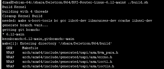

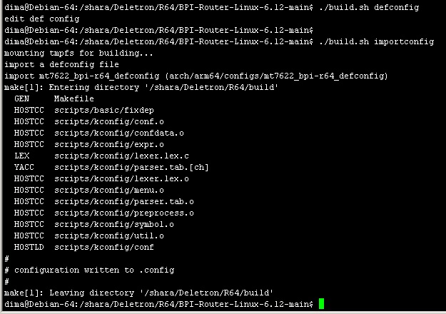

./build.sh importconfig
./build.sh config
made my changes
./build.sh
and nothing was saved, i got the default config
./build.sh defconfig # add your stuff
./build.sh config #verify it is set
./build.sh
Use “Pack” option at the end and copy file to images repo
Or use install to install direct to your sdcard (maybe you have to modify uEnv.txt to point to the right kernel itb file). you should see file loaded in bootlog before kernel is booting.

i have done
defconfig
importconfig
./build.sh config
config
./build.sh
build

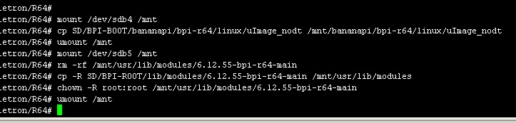

copy to a flash card
as a result, everything remains the same
iprule
what do i done wrong ?

Curent uboot for arm64 boards using fit image…so you have to copy itb file,not the uImage_nodt
Per default .itb is used,in your case bpi-r64.itb if filename differs you have to set filename in uEnv.txt (R64 has old path bananapi/bpi-r64/linux/ first for uenv.txt and afair also itb and fallback root as on newer boards.

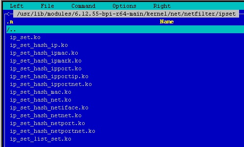

i have the ‘CONFIG_IP_SET=m’ option
and there is this module in the modules directory
ipset
but it’s not in the config.
