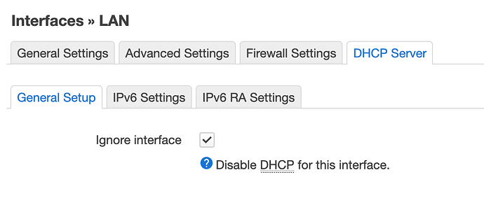

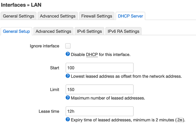

I am trying to setup a BPI-Wifi6. As I have already a home network, I want it to just be a DHCP client to my main network.
I have configured several other OpenWRT devices and they work perfectly when I do this. However, on this device, it works fine as long as it provides it’s own IP addresses, but as soon as i change it to DHCP client it doesn’t work anymore. Any ideas why?
Below are a few screenshots of my configuration (starting from the default BPI-Wifi6 config):

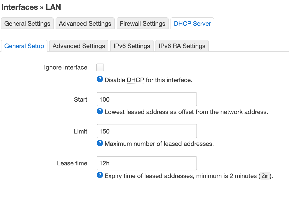

When set like this, it works fine (original config):

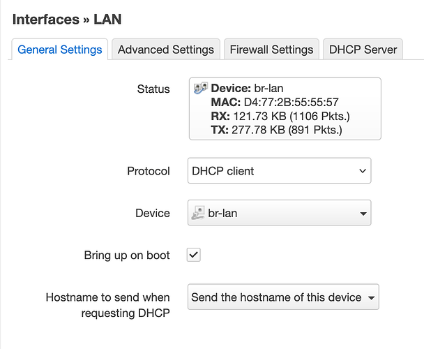

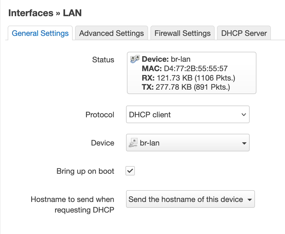

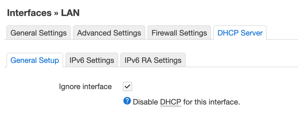

But when I edit to change for “DHCP client” in LAN it doesn’t anymore:

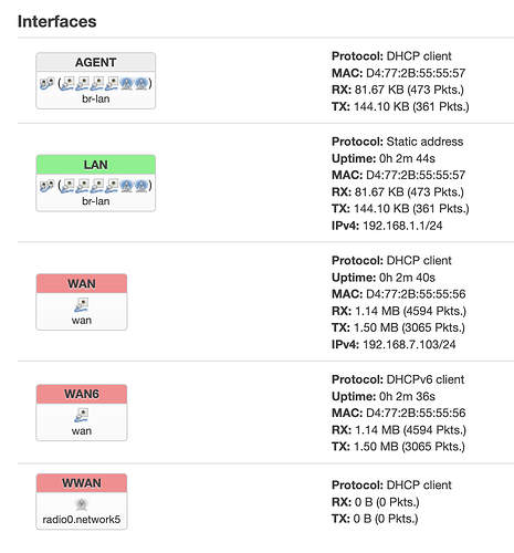

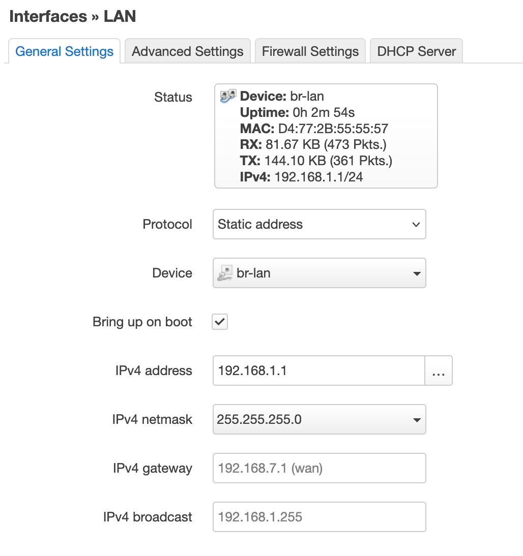

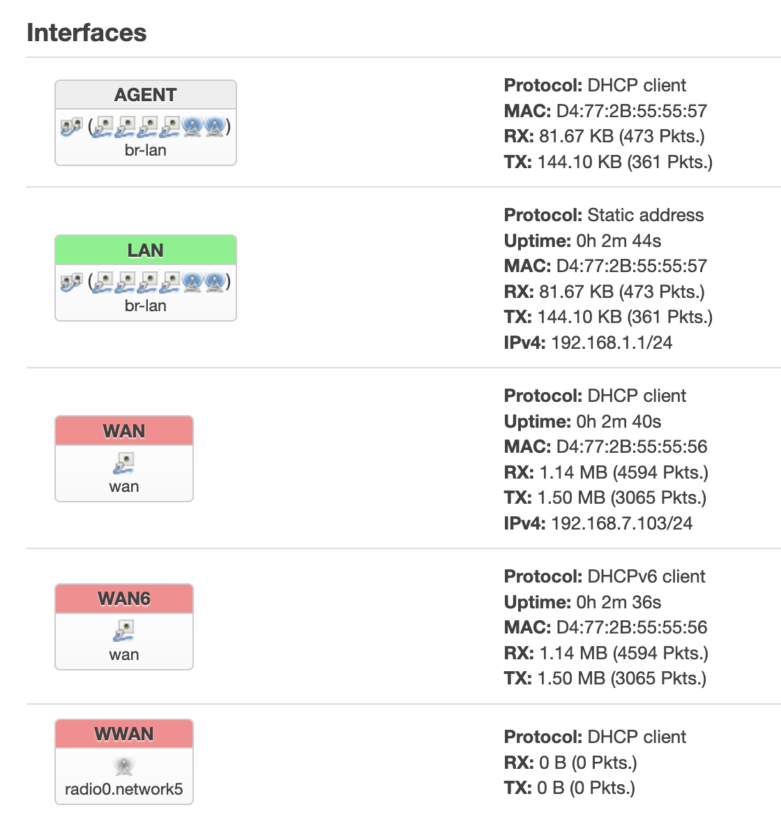

One additional interesting point, is that if I revert back to “Static address” it does not fix the issue. Even after a reboot. The only way I found to make it work again is to reload my previous backup of the settings.
Do I need to edit anything else in an other location?

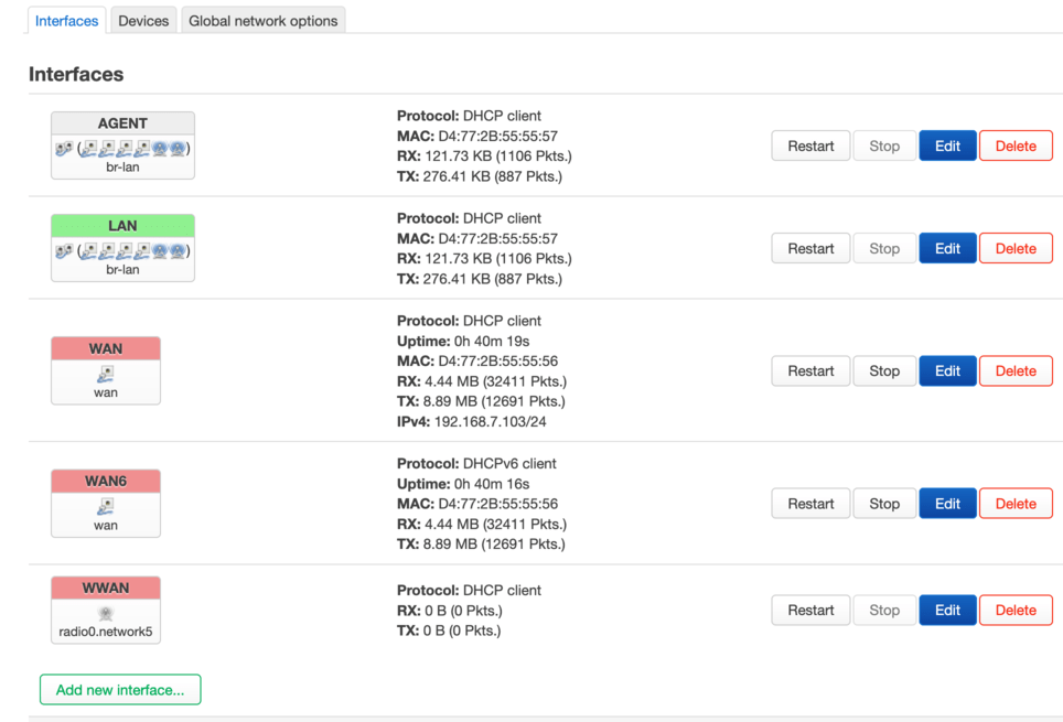

As wan is also dhcp client,i guess lan gets same subnet and so 2 interfaces have same subnet configured leading to invalid routing information
Sorry for the late reply, I’ve had an urgency to deal with and was not available for a few days.

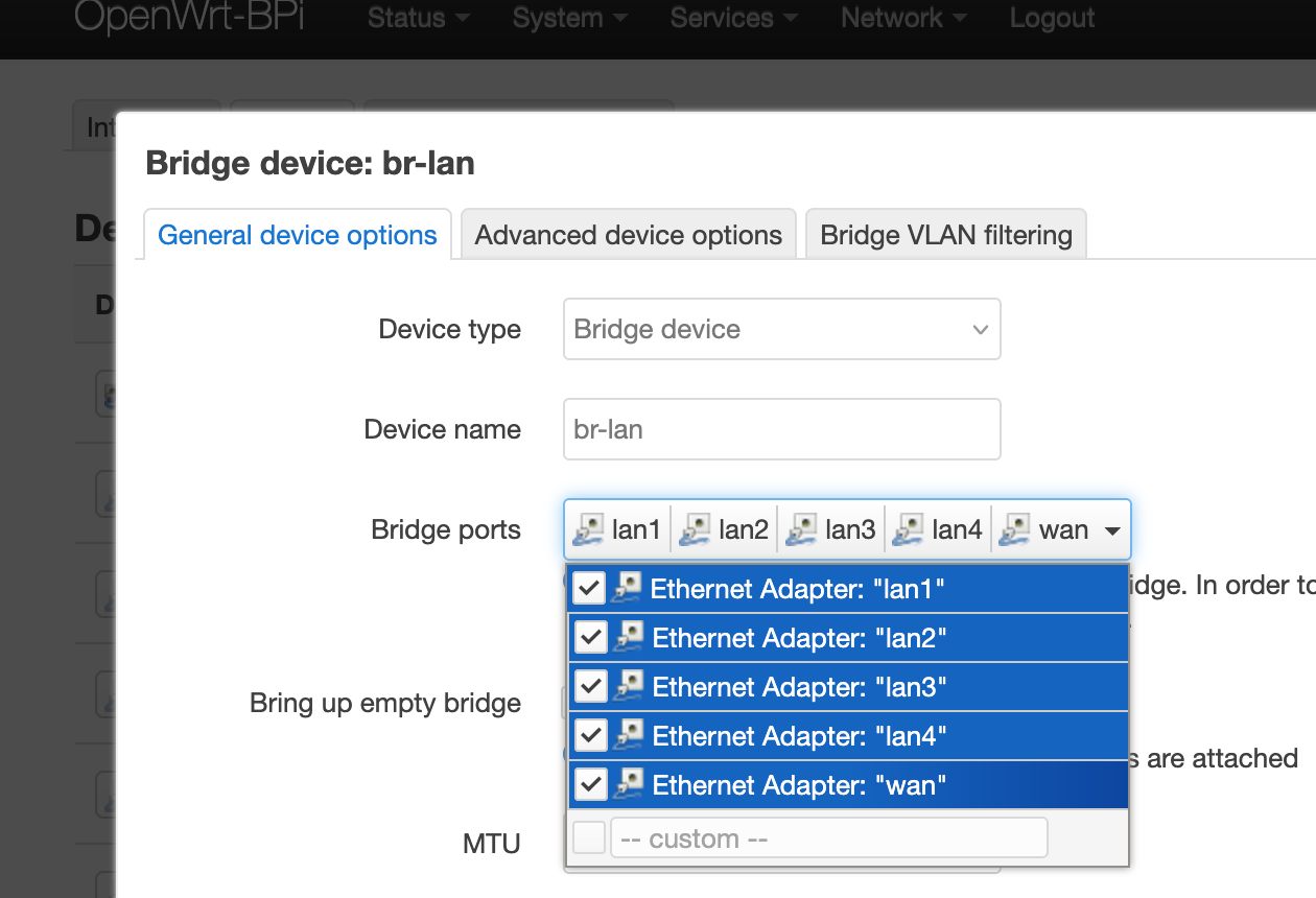

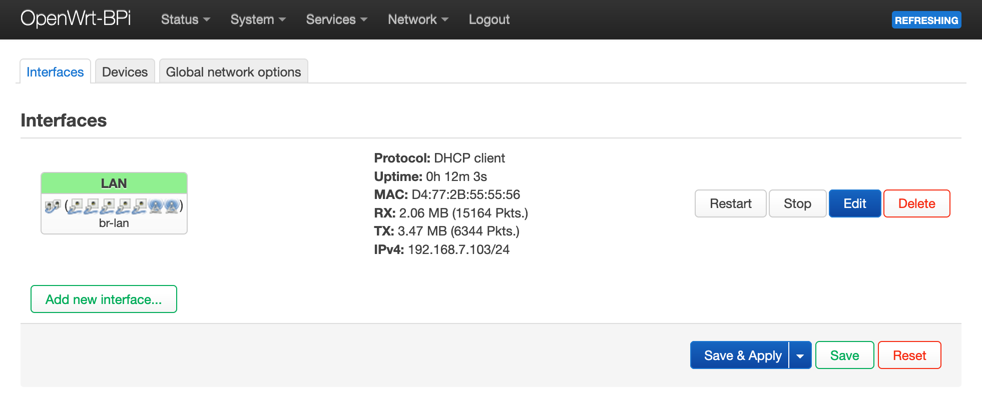

@frank-w your were right. I have now removed WAN and all the ethernet ports are working fine and are on the right subnet:
In Interfaces/Device I also ticked the WAN port:
Everything seems to work perfectly well now on the Ethernet ports. Thanks a lot for your help.
