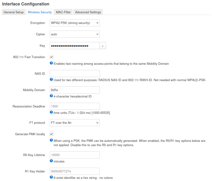

However I am having issues with wifi when using WLAN roaming 802.11r Fast Transition to integrate with the rest of my local network.
If the 802.11r Fast Transition is not ticked, I can connect to the wifi and everything works without any issues (for the test to run properly, all other wifi were disabled).
However, as soon as I set the “802.11r Fast Transition” and of course set the Mobility Domain with the same 4 digit hexadecimal value as my other Openwrt devices (the 2 other devices are OpenWrt One running on latest version) I cannot even connect to the wifi anymore. I am been asked for password without success (on the laptop) or just fails (on the Android phone).

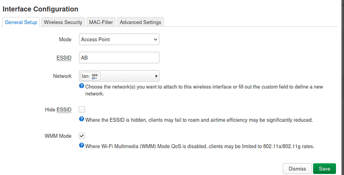

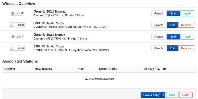

My configuration is as shown below:

/etc/config/wireless
config wifi-device 'radio0'
        option type 'mac80211'
        option path 'platform/wmac.1'
        option band '2g'
        option htmode 'HE20'
        option cell_density '0'
        option country 'CN'
        option channel '8'
config wifi-device 'radio1'
        option path 'platform/wmac.2'
        option band '5g'
        option country 'CN'
        option htmode 'HE40'
        option channel '153'
config wifi-iface 'wifinet5'
        option device 'radio0'
        option mode 'ap'
        option encryption 'psk2'
        option key 'password'
        option ieee80211r '1'
        option ft_over_ds '0'
        option ft_psk_generate_local '1'
        option ssid 'AB'
        option network 'lan'
        option mobility_domain '8d5a'
config wifi-iface 'wifinet1'
        option device 'radio1'
        option mode 'ap'
        option ssid 'AB'
Any idea on what may be wrong in my config?
