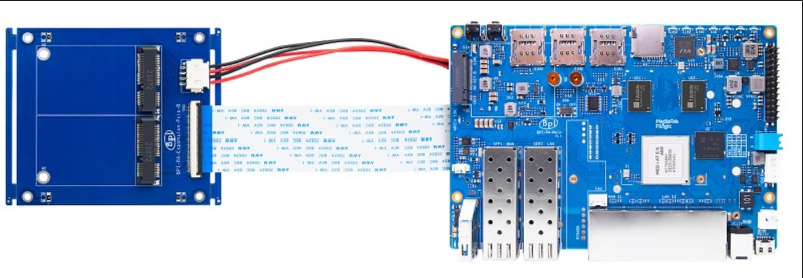

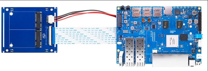

Is it possible to connect the BE14 module to PC?

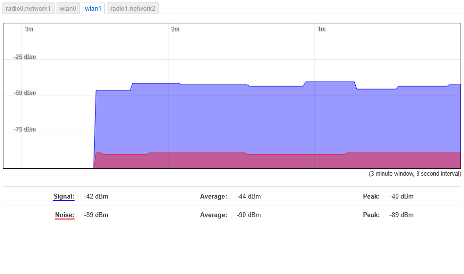

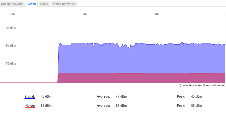

Maybe we could investigate the noise issues using this?:

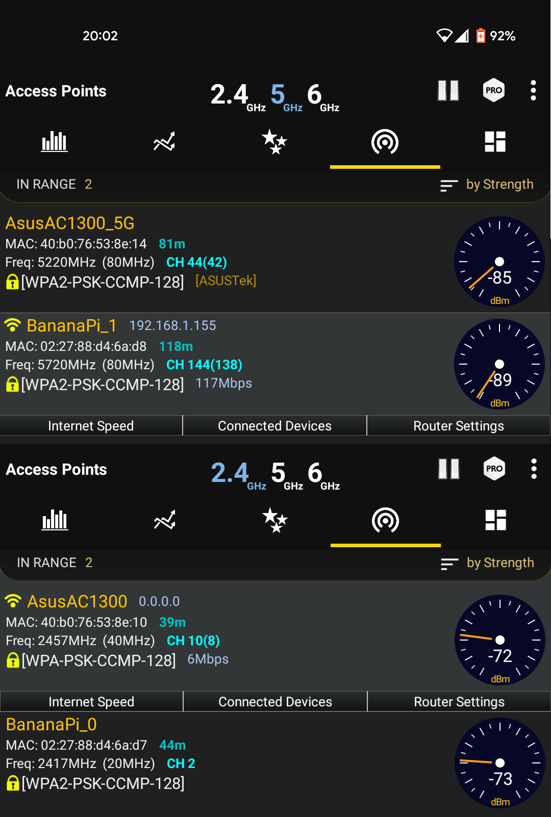

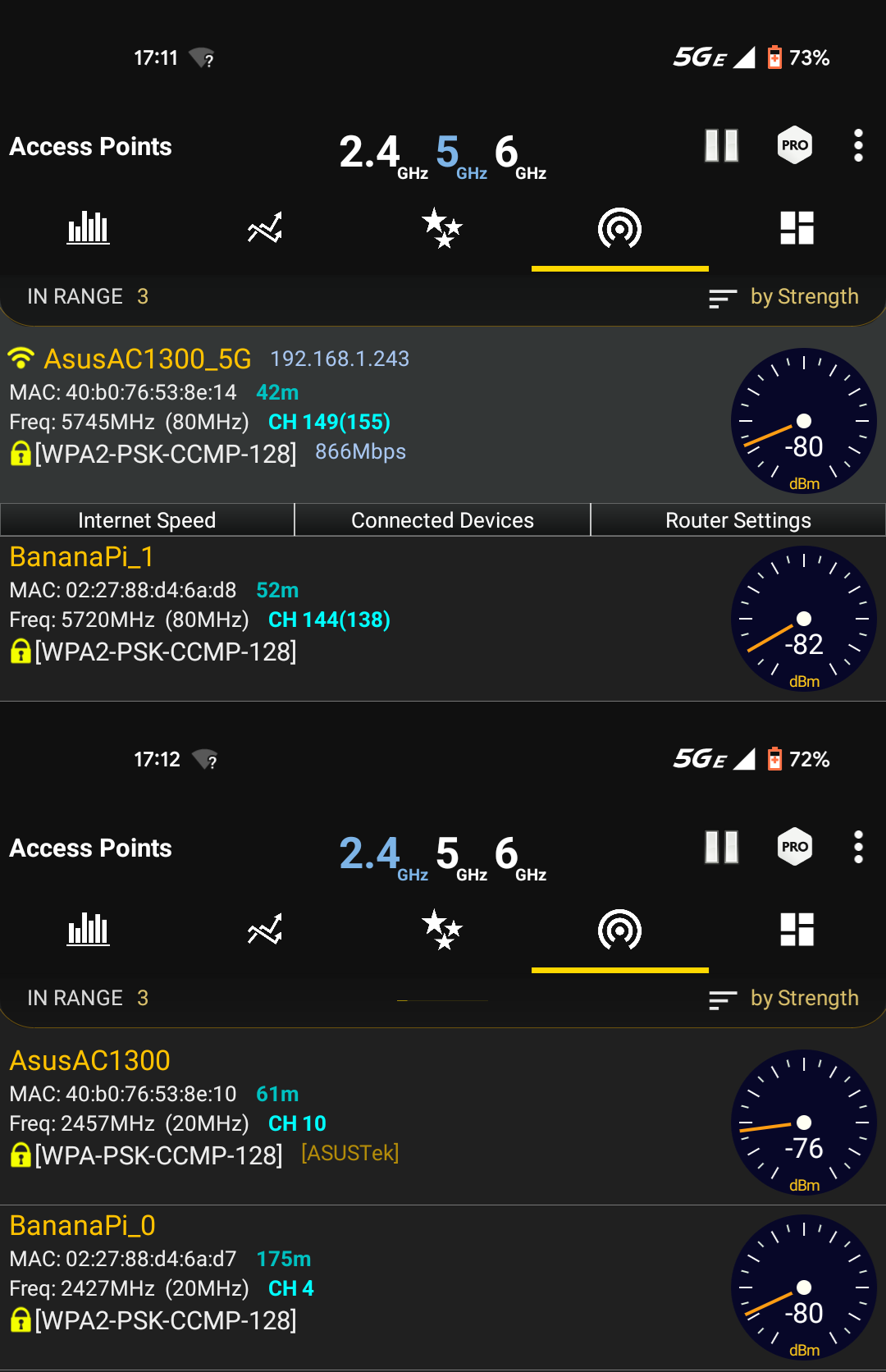

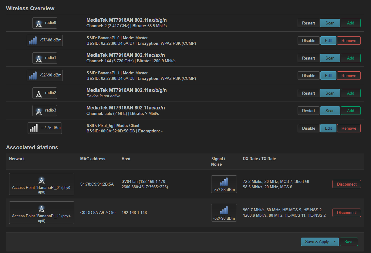

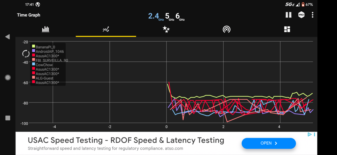

mostly going off of measuring range by how far i can get in the house while streaming virtualdesktop to a quest3. compared against my old asus ac1300 router. or running wifi analyzer/speedtests from my phone.
pic is taken with me standing right at the edge of reception range, asus can’t be connected to without failing, aw7916 still can, on both bands. lightmode openwrt is the asus, darkmode is the bpi-r4
thanks for sharing that. Could you do one more test to have similar environment:
  • on Asus switch channel from 44 to 100 (usually 100> has more power)
  • for 2.4GHz set also 40MHz, or change on Asus also to 20MHz
  • disable power saving on your phone
Thanks!
2g on the asus starts fluctuating a bit wildy if i set it down to 17dBm to match the aw7916. test isn’t very clean, i am going through atleast 3 walls, and standing maybe 30 or 40m from where the routers are. with tons of interference. :man_shrugging:
thank you for making that test. Now it is more clean for others to understand and compare results.
