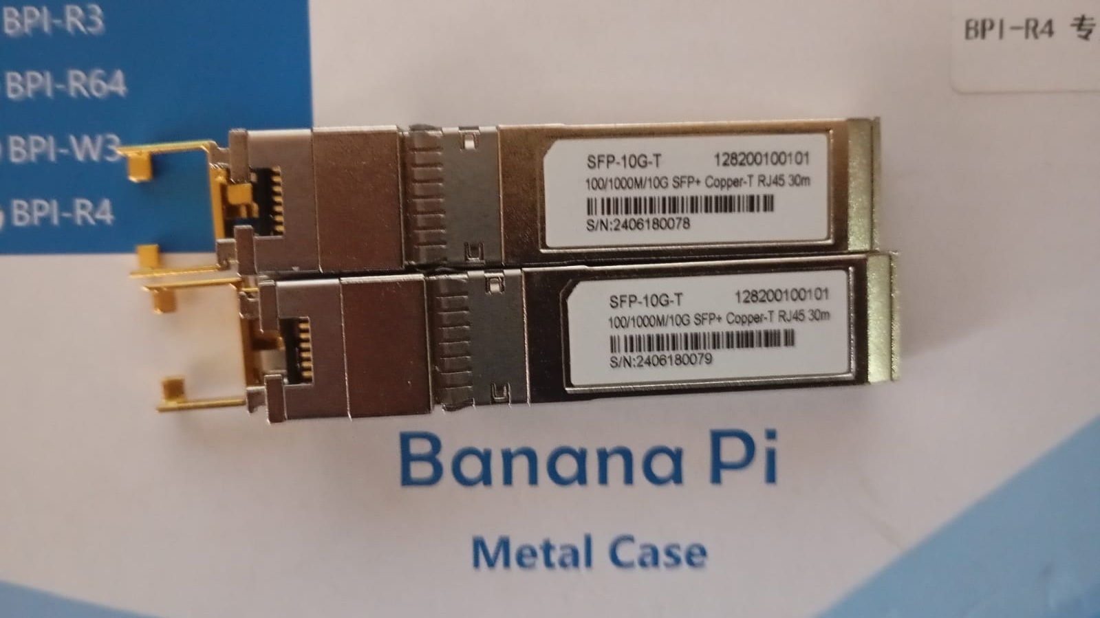

If I put the 10gb line to the 2 bananas I have, it shoots up to over 70 degrees in both, it doesn’t matter if I have the noctua or the heatsink installed.
If I put a 2.5gb line to the wan, they stay between 50 and 52 degrees.
If I put a 1gb line to the wan, it stays at 40 degrees.
I hope for your help and that you enjoy your vacation.

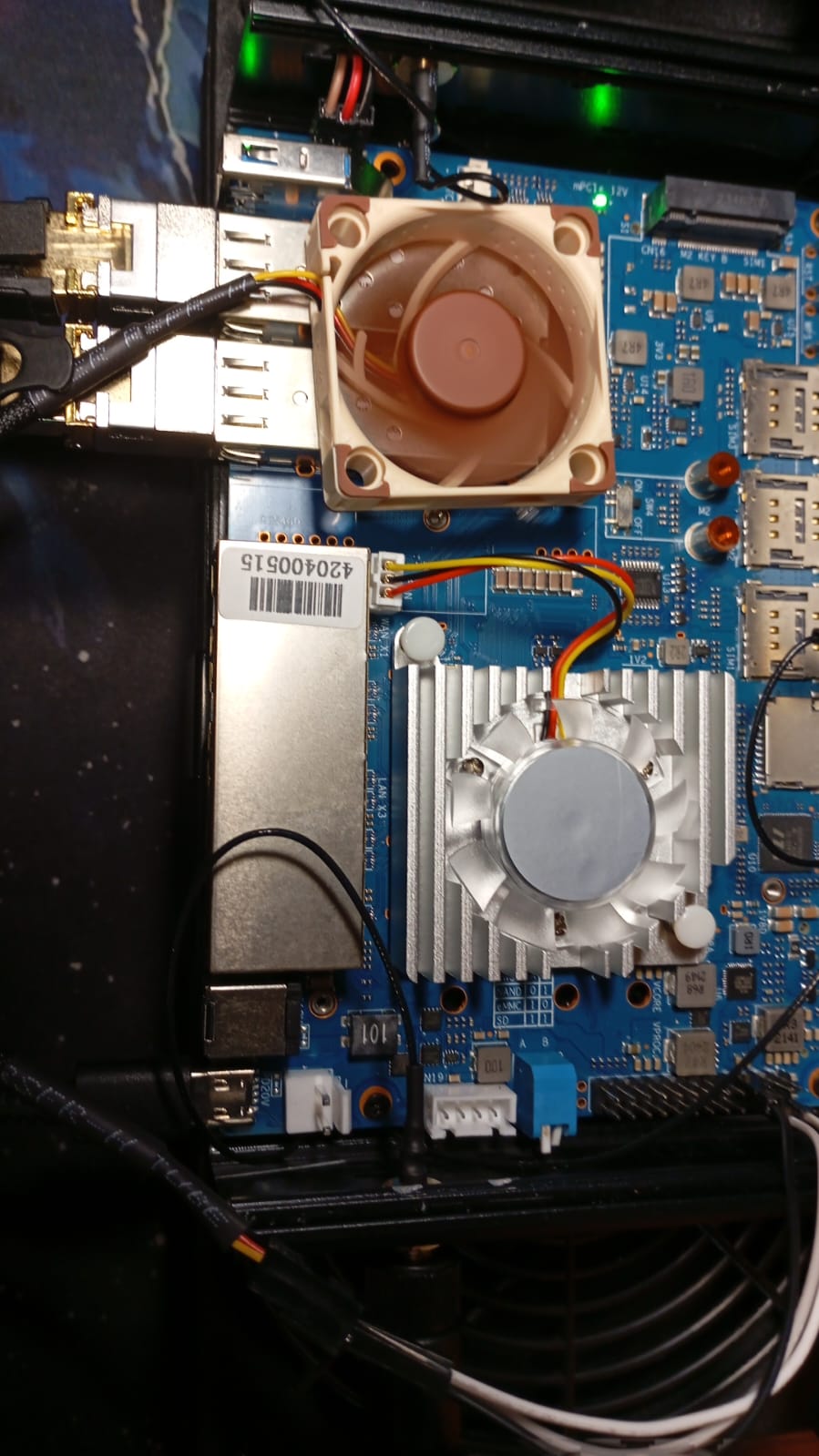

do not remove the heatsinks from the sfp ports when using the fan. do you use the noctua blowing on the sfp or does it suck from the sfp ports? I never had problems with the 10gbit sfp line from my provider, the only problem i had was with the sfp-rj45-adapter. not sure which heatsinks you use but it should never go over 70°C - is this aluminium or copper? where did you buy them?
I have tried the first banana I had with a heatsink and I have mounted another one today without a heatsink and the maximum temperatures reached were 75 degrees or so in both, both in the one that had a heatsink and the one that didn’t have a heatsink.
You mean to tell me that the problem is with the sfp+rj45 in the 2 I bought.
its too many variables that can lead to this. i am not sure but iirc i have my fans sucking, not blowing mounted. tbh i am very unhappy with the other stuff from sinovoip so i bought those heatsinks that were mentioned here, cant check now coz i dont have access to aliexpress right now. paste exact information about the sfp adapters you have problems with.
The temperatures of the rest are all perfect, but if I put the 10gb line that I have contracted to give it internet, then the temperature shoots up in the sfp+ I’ve changed them from one side to the other in the same banana, I’ve also tried them in the second banana that I bought.

10GBASE-T transceivers like that which are rated for 30 meters are the old kind that usually have notably higher power consumption than modern ones that are rated for 80 or 100 meters. The newer ones can be as much as 30 °C cooler when linked at 10 Gbps. There are very few situations where the older ones make sense now that the prices of the new ones have been driven down a lot. Brands like ZYOPM and Xicom sell them on AliExpress. I have one of each that I can test for compatibility in the BPI-R4 once I set mine up.

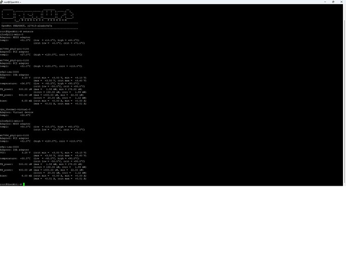

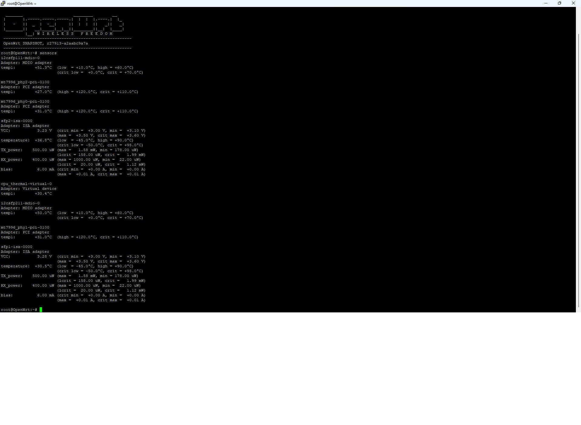

also - do anybody else has the issue that original bpi ethernet (copper/rj45) sfp’s (10gig ones rated for 30meters) heat up to ~100+ degrees (celsius) when connected and negotiated 10g link and not even sending much data ? like idle.
can it be firmware issue ? i’m using woziwrt (GitHub - woziwrt/bpi-r4-openwrt-builder: mtk openwrt builder)

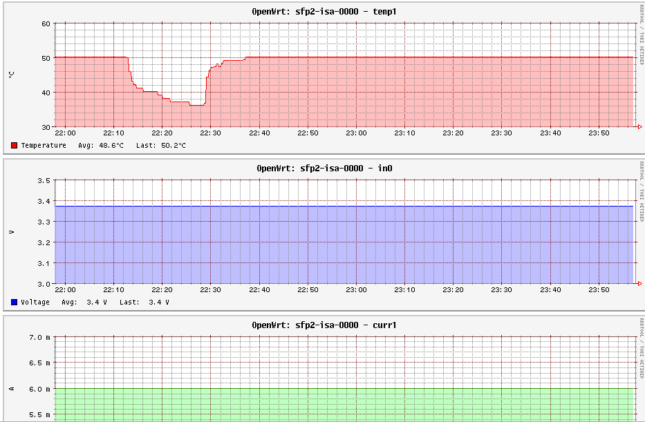

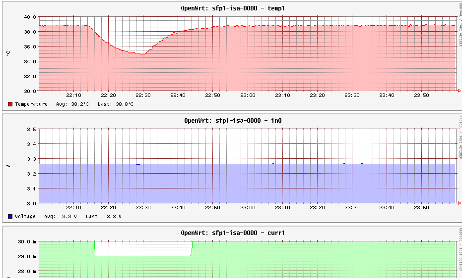

when i added the fan - in the same manner as @TheServer201 (thanks for the plate <3) , all temperatures went down in the BPI overall, almost
sfp1-isa-0000 went down to ~36 degrees
but i2csfp111-mdio-0 is still rising towards 100+ (slowly gradually from 66 degres) over period of one hour it went up to ~99.5 and still rising.
where it’s from ? which part of the router is actually getting hot ? as i understand sfp1-isa is a sfp insert, what is i2csfp111-mdio-0 monitoring ? i suppose it’s not internal CPU/SOC i2c module because it would affect overall temp of SOC too - but it doesnt affect cpu_thermal. so - what is it ?
also when i removed insert - it was quite cold to the touch .
