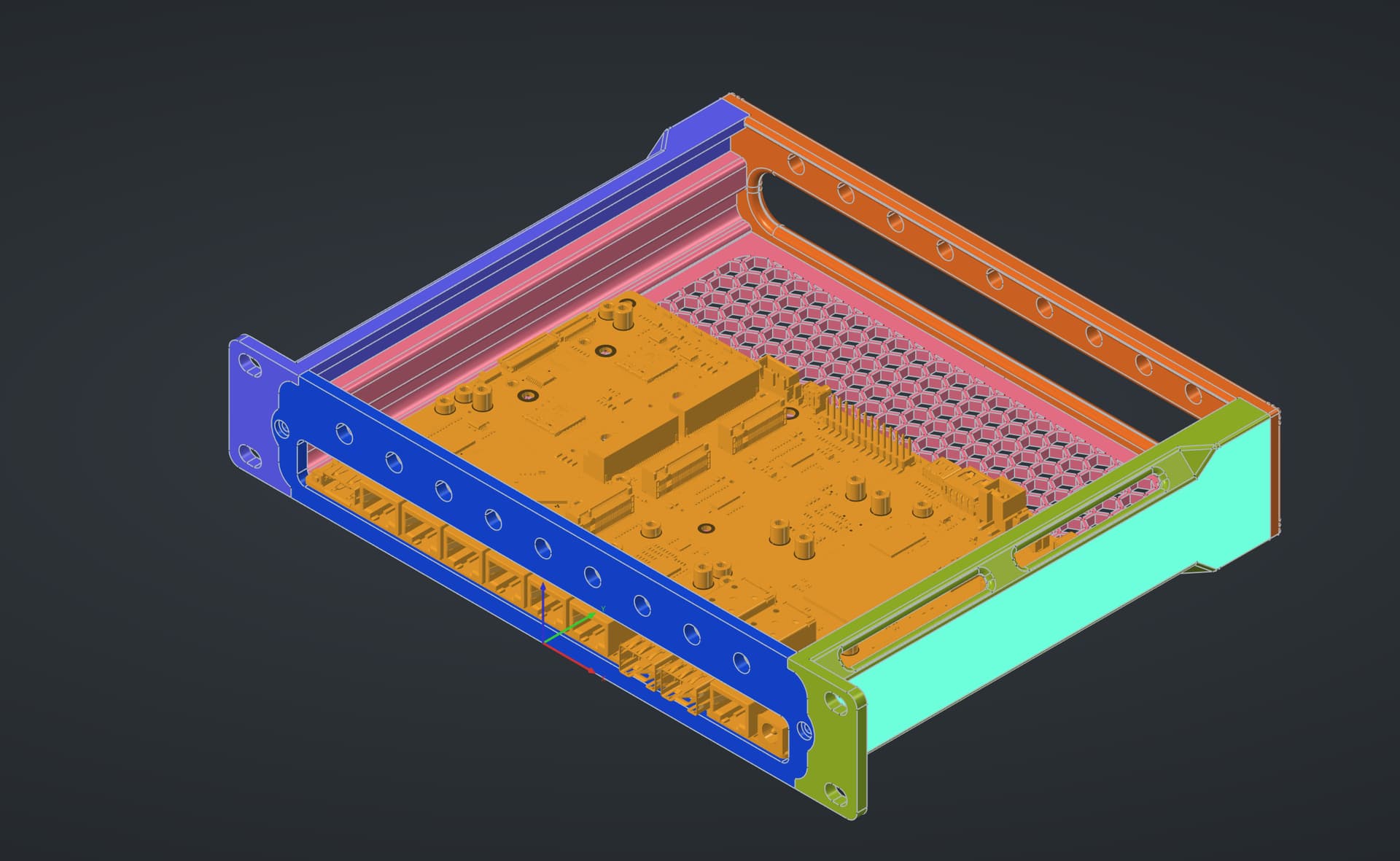

Good job, I’ve also almost completed my version for the 10’ rack. As soon as I test it, I will make it publicly available. I also wrote about the white briefcase, they said it was out of stock and they would write

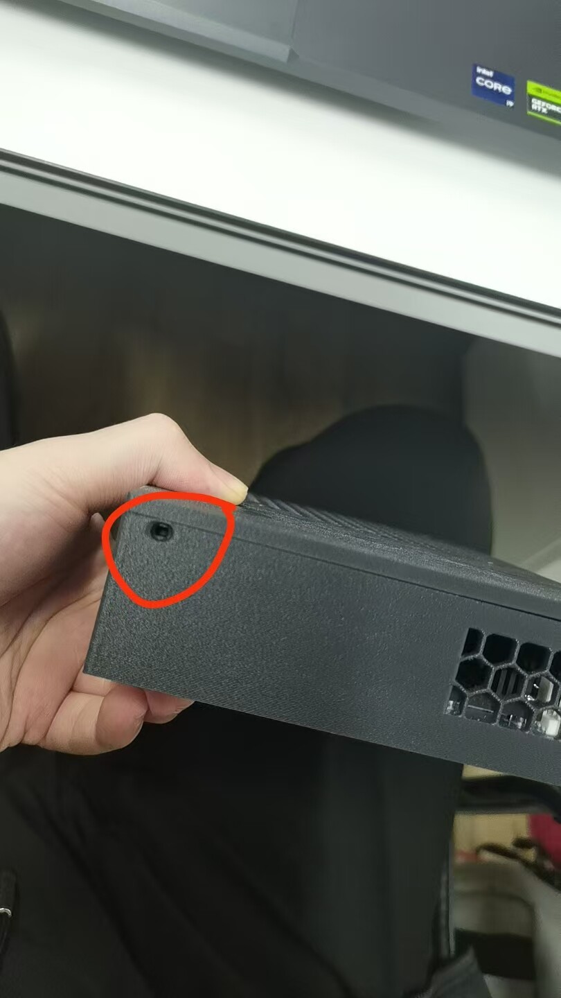

Could you please tell me which type of nuts are used to fix the two connected lids that you 3D-printed?
i used M2 ones taken here https://www.aliexpress.com/item/1005007830491580.html

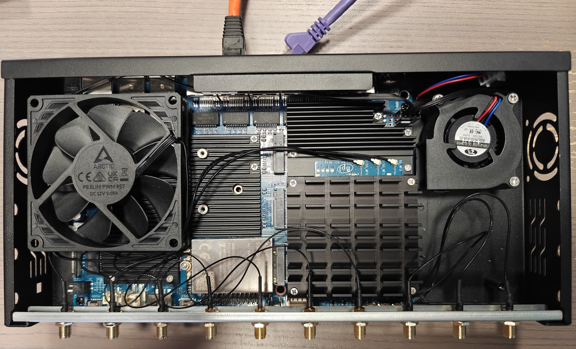

I got some updates on my layout with the official case.
I placed an Artic slim fan blowing on top - that one conveniently comes with a splitted connector so I could connect the side blower as well.
I also have assembled the big official sink for the BE14, the one without the fan. Is it… satisfyingly big.
I guess the version with the fan is aimed at the upcoming BE14 v1.1 - I’m hoping that the new BE14 will have a fan header in the top side (I guess the pins are already there, they can be seen in the picture above, but not soldered to a header) so the board can control the fan indipendently from the main.

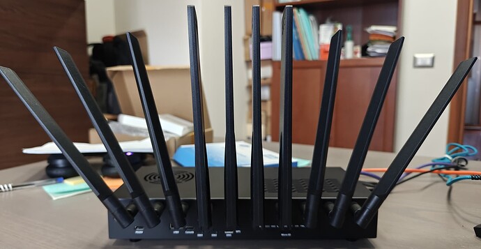

When you close it down, wifi and LTE, it looks like this:
(yes, I admit I moved the LTE antennas in the middle just for aesthetic purposes… :smiley:)
ATM I would call myself satisfied even if the whole thing is on the “big” side. I’ve seen many interesting 3d models in this thread that I would have wanted to use but none accounts for 10 antennas… :face_with_diagonal_mouth:
