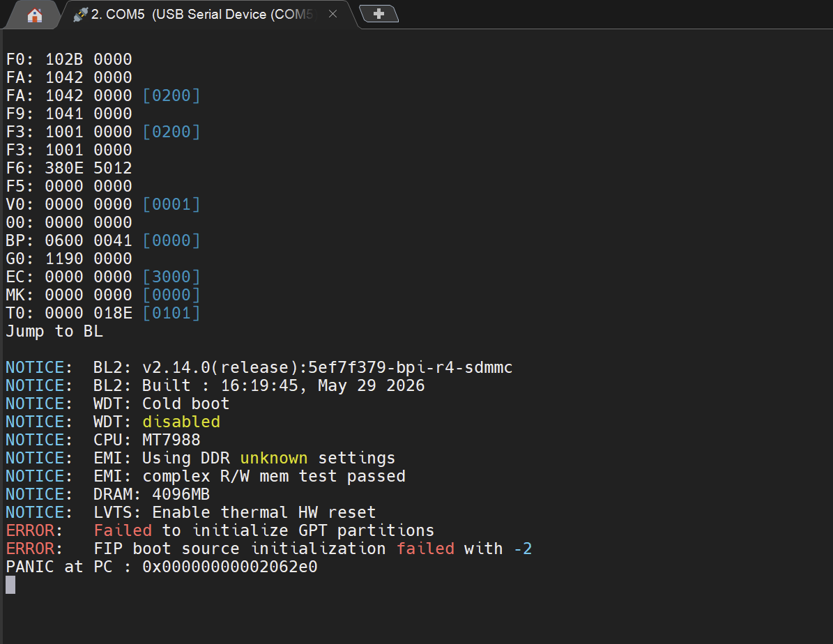

Alright. This is where the openwrt-mediatek-filogic-bananapi_bpi-r4-pro-8x-sdcard.img image from your repo is stopping. Not much text to log but, I will also provide that.
Ah ok.
I’m definitely doing the process incorrectly.
I’m using Win32 Disk Imager to write to the sdcard.
Do I need to compose the two images (openwrt and bl2) in a single one?
Sorry Frank this is getting more confusing by the message.
You want me to flash openwrt on the sdcard, and then flash bl2 on the same card?
This will overwrite the memory of the entire card with the content of the bl2 since Win32 Disk Imager always sets the whole sdcard.
That’s why I’m asking if I need to compose bl2 and openwrt in a single .img before I flash the final img.
Mhm,if win32imager erases the full card this is bad…but replacing a piece of image is imho more difficult than writing on spcific partition…don’t you have a linux system there to write the bl2 to partition 1?
