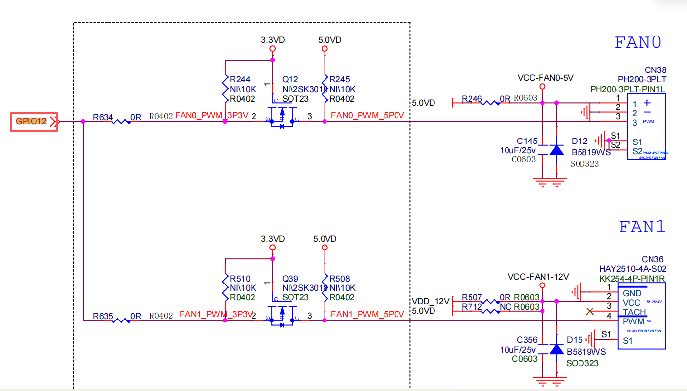

I’ve got the BPi-R4 lite and the BE14 WiFi 7 module. I got the fan and heatsink, which as people have said, fits properly. However, the fan does not run. I’ve plugged it into the 12v 4pin header and am running the supplied software. I’ve installed 'OpenWRT-24.10 MT76 OpenSource wifi driver wifi SDK for BE14000 Wifi Card(1 PCIE,2 Lane) software, which doesn’t appear to have fan control so I installed several fan control packages, but none control the fan…

Please can someone advise me how to get the fan running on BPi-R4 lite??
I’m not sure if the image has PWM control configured for this GPIO. Perhaps you could check the /sys/class directory for a relevant .pwm file and try changing the corresponding parameters.
Thanks for the info but could you clarify which file to check, please? Cheers…
