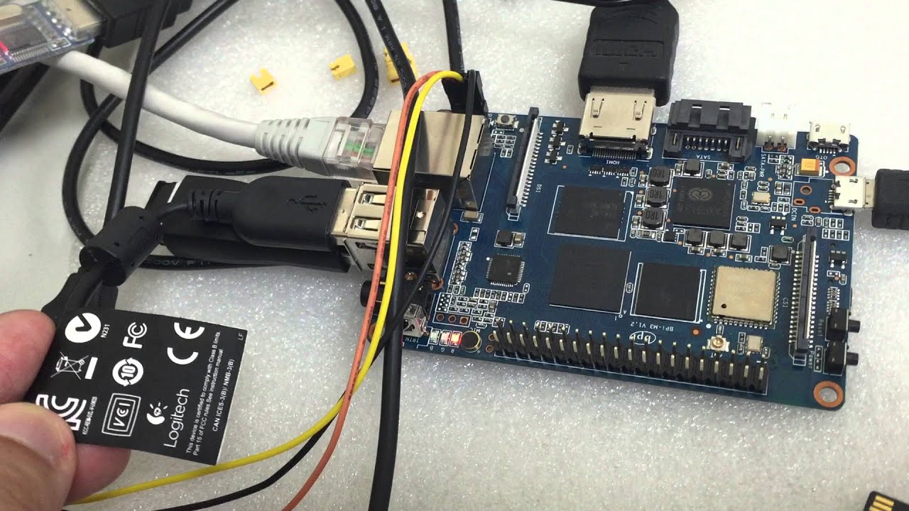

USB camera : Logitech C920r HD Pro
http://www.logitech.com/en-hk/product/hd-pro-webcam-c920
Step 1 :
Burn the Android Images onto the SD-Card
http://www.banana-pi.org/download.html#e-panel
Step 2 :
Install thrid-party apk (USB Camera Trial 2.1.7 APK)
http://apk-dl.com/usb-camera-trial
Step 3 :
Open USB Camera Trial 2.1.7 APK
logitech C920r HD Pro Video Demo:
logitech C920r HD Pro:
Regular USB camera (supporting UVC driver)
