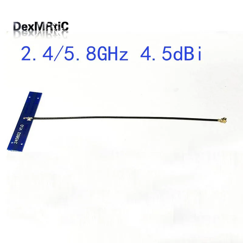

If you need an antenna, you can go with anything that uses an IPX connector.
I used a PCB antenna that came from another kit, the MAIX Sipeed
The web page doesn’t show the antenna, but it looks similar to:
There are also “rubber duck” antennas and other types too. I suppose if you had a dead PC laptop you could harvest one of its antennas too.
