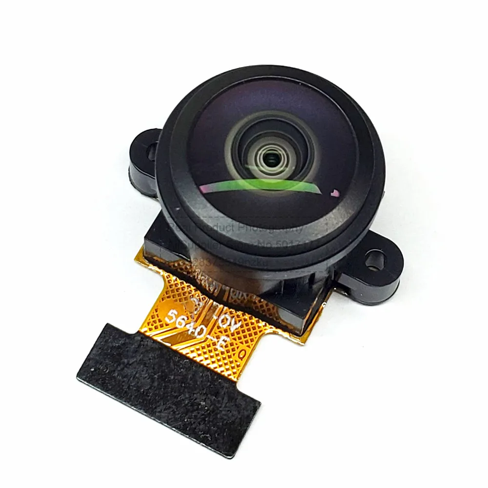

Is it possible to connect such device wth wide angle lenz?
I think so. It seems to be the same connector, and, indeed, it says OV5640. So give it a try.
Hello friend :slight_smile: I show pin description of this 5640 sensor (200 degree) and Schematic diagram of M2 Zero device. And I reworking fpc-24 connector. And I understanding what this very bad solve and better to buy ready-made reverse flat cable.DSCN2713 My dmesg such as:
