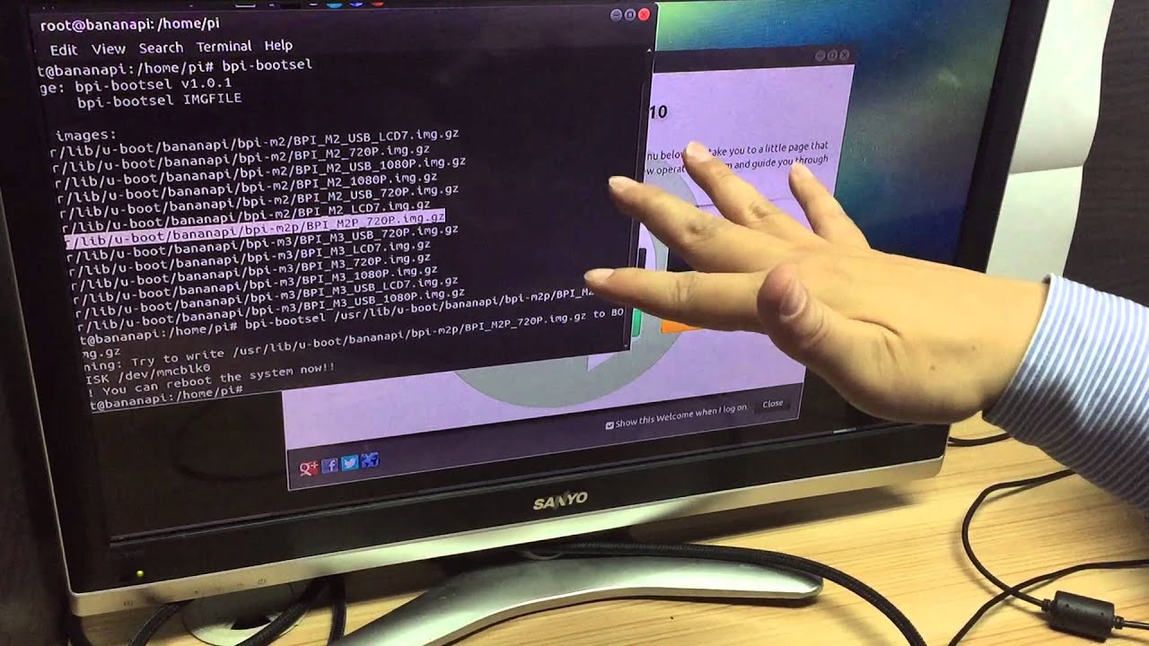

[BPI-M2+] how to use BPI-M3 SD card image to boot BPI-M2+(H3 version), use bpi-bootsel
how to use banana pi BPI-M3 image on BPI-M2+ , use bpi-bootsel
on BPI-M3 board: (login as root) step 0: download https://github.com/BPI-SINOVOIP/BPI-files/blob/master/debs/linux-bananapi-bpi-m2p-kernel3_1.2.3_armhf.deb step 1: dpkg -i linux-bananapi-bpi-m2p-kernel3_1.2.3_armhf.deb step 2: bpi-bootsel /usr/lib/u-boot/bananapi/bpi-m2p/BPI_M2P_720P.img.gz step 3: mkdir -p /boot/bananapi/bpi-m2p step 4: cp -a /usr/lib/u-boot/bananapi/bpi-m2p/linux /boot/bananapi/bpi-m2p step 5: cd /boot/bananapi/bpi-m2p/linux ; vi uEnv.txt (if you want to change) step 6: poweroff & remove SD card.
on BPI-M2+ board: step 7: insert SD card and power on
log on BPI-M3:
root@bananapi:/# dpkg -l | grep bananapi
ii  bananapi-bpi-tools                    1.0.1
     armhf        Banaan Pi:  tools
ii  linux-bananapi-bpi-m2-kernel3         1.2
     armhf        Banaan Pi BPI-M2:  linux kernel 3.3 image & modules
ii  linux-bananapi-bpi-m3-kernel3         1.2.6
     armhf        Banaan Pi BPI-M3:  linux kernel 3.4 image & modules
ii  linux-firmware-bananapi-bpi-wifi      1.0
     armhf        Banaan Pi: linux kernel firmware for wifi ap6181 & ap6212
root@bananapi:/# dpkg -i linux-bananapi-bpi-m2p-kernel3_1.2.3_armhf.deb
Selecting previously unselected package linux-bananapi-bpi-m2p-kernel3.
(Reading database ... 213272 files and directories currently installed.)
Preparing to unpack linux-bananapi-bpi-m2p-kernel3_1.2.3_armhf.deb ...
Unpacking linux-bananapi-bpi-m2p-kernel3 (1.2.3) ...
Setting up linux-bananapi-bpi-m2p-kernel3 (1.2.3) ...
ii  linux-bananapi-bpi-m2p-kernel3        1.2.3
     armhf        Banaan Pi BPI-M2P:  linux kernel 3.4 image & modules
root@bananapi:/# bpi-bootsel
usage: bpi-bootsel v1.0.1
       bpi-bootsel IMGFILE
bpi images:
/usr/lib/u-boot/bananapi/bpi-m2/BPI_M2_USB_LCD7.img.gz
/usr/lib/u-boot/bananapi/bpi-m2/BPI_M2_720P.img.gz
/usr/lib/u-boot/bananapi/bpi-m2/BPI_M2_USB_1080P.img.gz
/usr/lib/u-boot/bananapi/bpi-m2/BPI_M2_1080P.img.gz
/usr/lib/u-boot/bananapi/bpi-m2/BPI_M2_USB_720P.img.gz
/usr/lib/u-boot/bananapi/bpi-m2/BPI_M2_LCD7.img.gz
/usr/lib/u-boot/bananapi/bpi-m3/BPI_M3_USB_720P.img.gz
/usr/lib/u-boot/bananapi/bpi-m3/BPI_M3_LCD7.img.gz
/usr/lib/u-boot/bananapi/bpi-m3/BPI_M3_720P.img.gz
/usr/lib/u-boot/bananapi/bpi-m3/BPI_M3_1080P.img.gz
/usr/lib/u-boot/bananapi/bpi-m3/BPI_M3_USB_LCD7.img.gz
/usr/lib/u-boot/bananapi/bpi-m3/BPI_M3_USB_1080P.img.gz
root@bananapi:/# bpi-bootsel /usr/lib/u-boot/bananapi/bpi-m2p/BPI_M2P_720P.img.gz
Warning: Try to write /usr/lib/u-boot/bananapi/bpi-m2p/BPI_M2P_720P.img.gz to BO
OTDISK /dev/mmcblk0
OK!! You can reboot the system now!!
