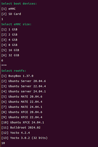

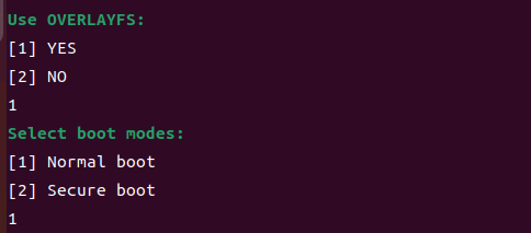

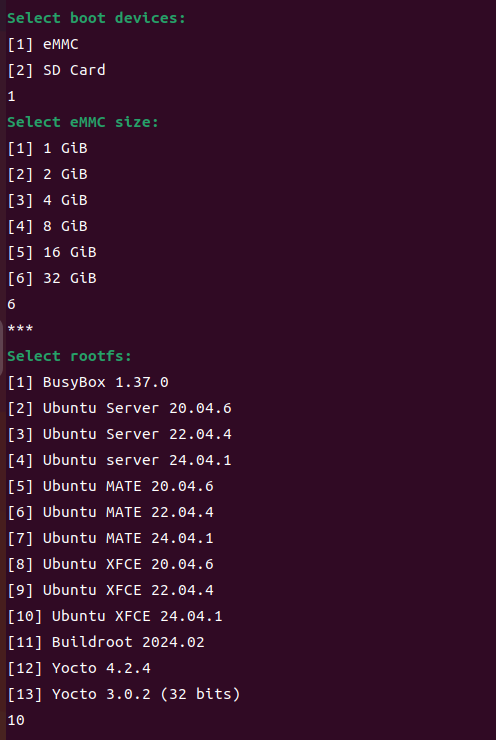

4.Execute make config in the root directory of the code. The first time you run it, it will automatically download all the necessary toolchains from the Internet.
After the download is complete, the hardware platform options will be displayed, including different customer platforms and development board abbreviations.
Select as follows:
25e4a2847adf3f95e05c8719e881bd1
c9d2ee9e795f1948ba12fc86c439eca

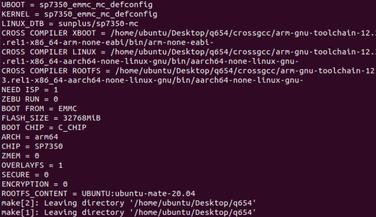

After selection, precompilation will be performed automatically. Once completed, the results will be displayed as shown in the figure below, displaying the configuration information entered earlier. 7f4c470f3863c354e03cedf36ceb22c

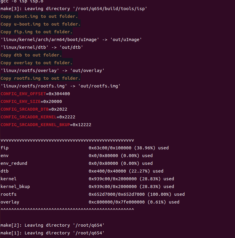

  1. Execute the following code to compile the entire code. Each directory file will be compiled, and after compilation is complete, the 【out】 directory will be generated, which contains the files required for the upgrade burn.
make all

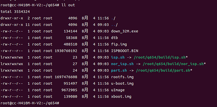

After compilation, the result is shown in the figure below, indicating that the compilation was successful [EMMC boot].
If there is an ISPBOOOT.BIN file, then it is successful. ISPBOOOT.BIN is an EMMC burning file.
