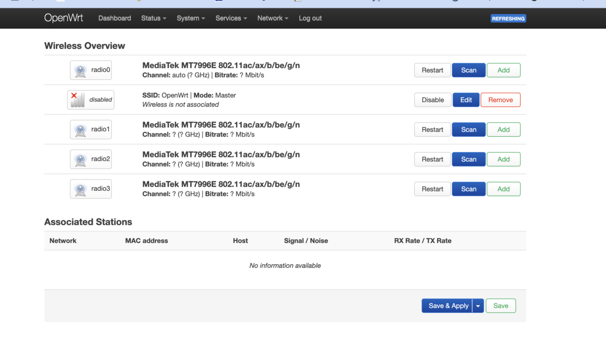

I tested your image to the sfp and was good thanks. But the wifi was not working
Sorry, the configuration I gave you is for a Banana Pi Pro 8x, so it’s not valid.
Here’s the latest link to my build; try it and let me know.
