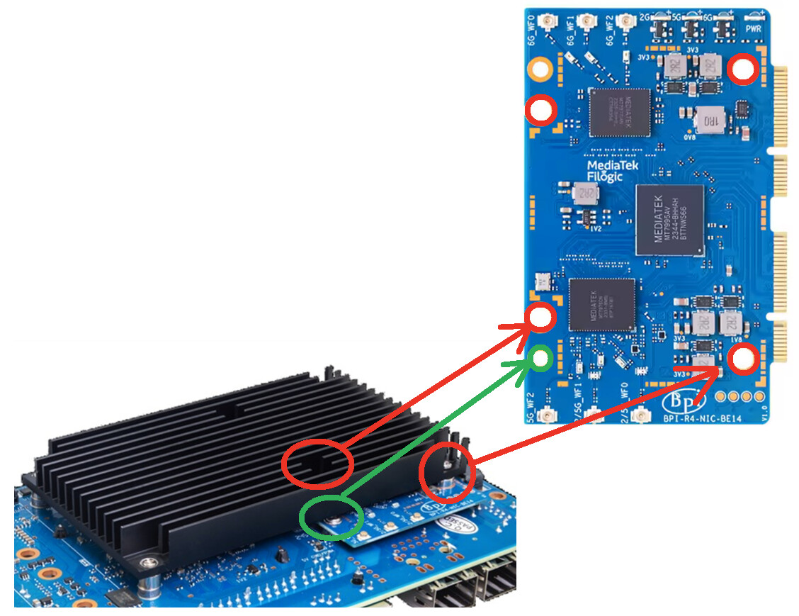

I contacted Judy - but it seems this massiv heatsink will not be sold “alone” - as it will not fit the standard BE14 module. Sinvoip did hand solder some spacers on their BE14 for their new larger case, and you need those spacers to screw the heatsink to it.
Bummer - I really wanted to use that heatsink for my custom enclosure and could solder the spacers myself - or use “double-screws” as found on the smaller heatsink sold by Sinvoip.
I’m attaching the picture for your message:
Thanks, yes - I know, but Sinvoip told me, you need to have a special BE14 board with those spacers soldered to it - my board just has holes there, nothing to screw into.
They told me, they hand solder the spacers on that BE14 board just for that larger case package they sell.
I wasn’t aware of this until your post — after that, my tinkering started :+1:
I don’t understand what they’re planning… because the new BE14 is coming, but it has the same mounting holes!
I’m a bit worried that Banana Pi isn’t really caring about the “older” R4 anymore. The documentation for R4 Lite and R4 Pro includes power measurements, for example. Even though the new BE14 seems to have good PCB shielding/insulation, proper shielding on the PCB will probably still be required. I’m hoping Banana Pi will address this. I wouldn’t spend any money on anything until the new BE14 is out and some questions are answered…
If they sell the taller case, they should also sell the heatsink together with the spacers. For most people, soldering this shouldn’t be a big problem… (or they can find someone locally to help).
