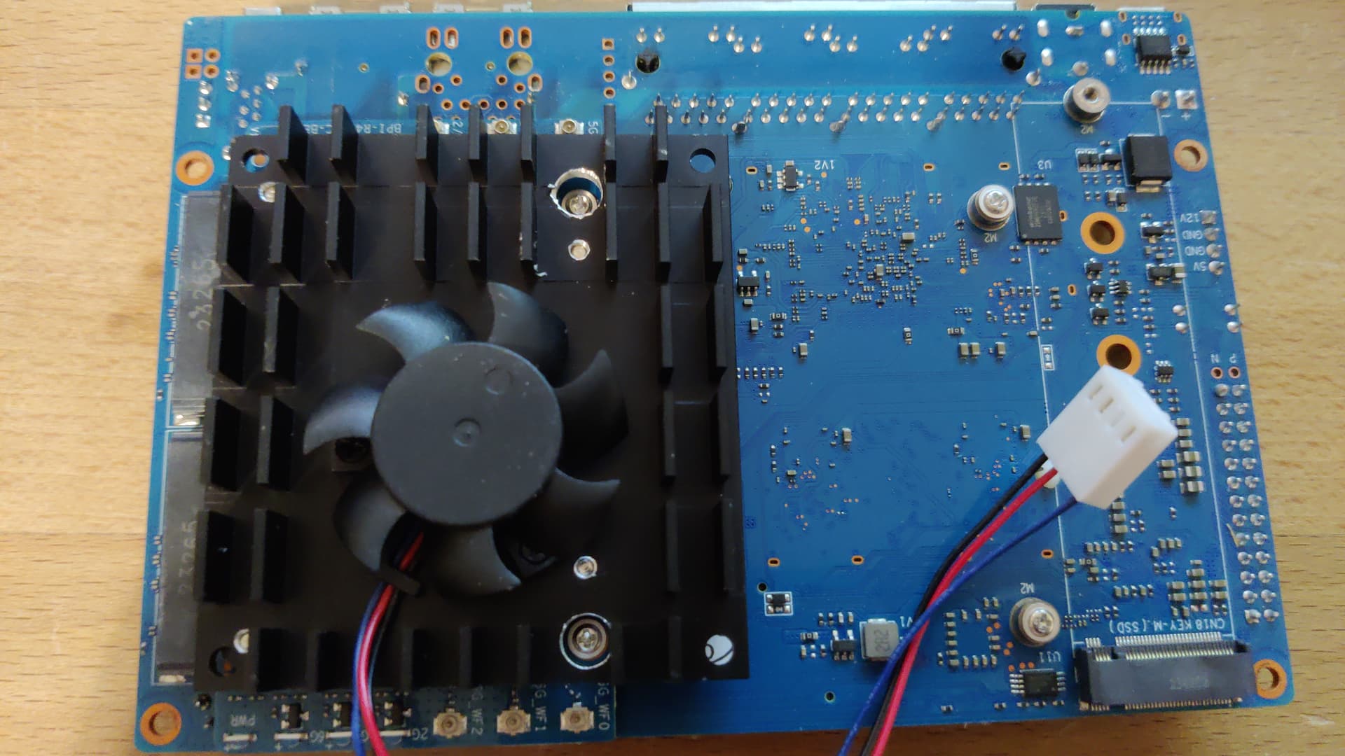

I’ve adapted the headsink to BPI-R4…
This DIY looks quite good, but this board no longer has the extra fan power supply interface.
