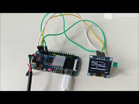

I have this same OLED screen. Need to test.

And how did you get the OLED to display like the video? Here is my output after compiling and running the OLED example.
I appreciate you guys trying to help me figure out why it wasn’t working for me, but I only have until the end of the week to finish the evaluation, so I already moved ahead with my own mod, which works on all 8 images I have tried regardless of kernel or networking abilities.
The OLED sample also did not work for me, it only shows the date in the command line output. So I wrote a new one which works on both the 128x32 and 128x64 OLED i2C modules I have. This is enough for me to finish my evaluation.
