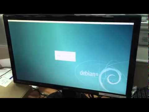

Banana Pi BPI-M2 A31S runs Debian 8 Jessie and LXDE
Hi;
Where os image download link? This video runing Ubuntu with M2.
