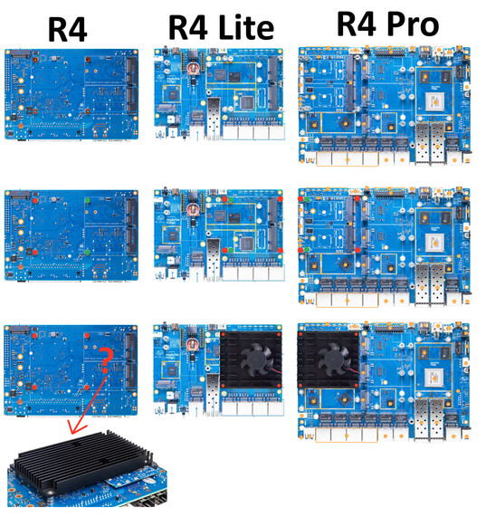

  • It appears to match only with the R4 Lite and the R4 Pro.
  • Combined with this information:
… it doesn’t smell good :see_no_evil:
Yeah, i’m little pissed, but oh well. I just hope there will be some proper heatsink for the original bpi-r4 and be14 especially since i bought the taller case.

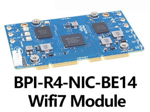

I still don‘t know how that fan would fit on the lite or pro, they use the same BE14 board?
Or do they also need a modified BE14 with spacers soldered to the gold-holes (like the same problem as with the massive fan)? And then rotate the fan 90° and screw them with 2 screws on the BE14 board and 2 screws on the main-router board?
Image of the modified BE14 boards with spacers soldered to it: BE14 with spacers

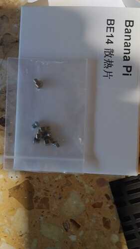

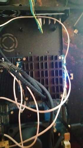

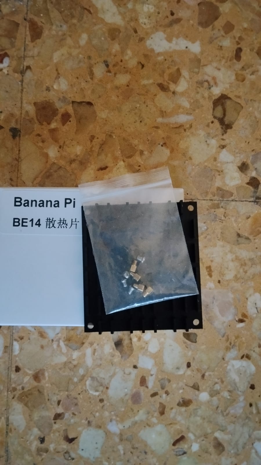

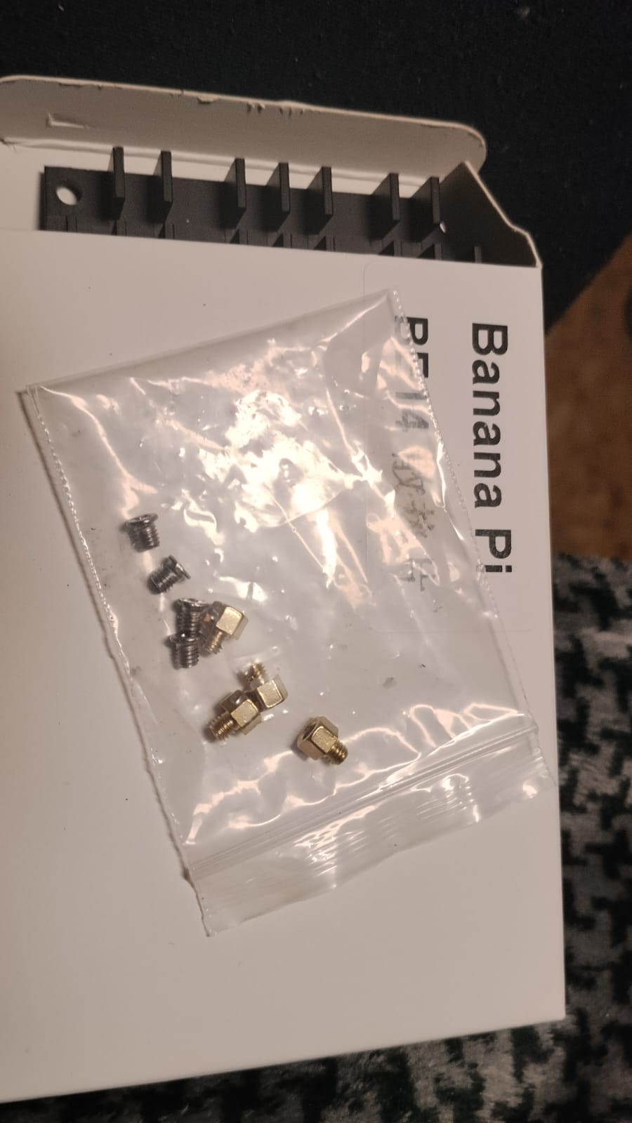

Good, I said it fits the heatsink perfectly. It should have come with some screws and brackets like these.
You should first insert the gold brackets into the motherboard and then insert the screws.
I’ve attached some pictures.
Regards
OK, that would make more sense - but at least for the normal BPI-R4 you could only screw two of those into the BE14 board, as the spacing on the heatsink are larger than the board itself.
I guess the same could work for the larger heatsink then… I ask Judy if that would work as well…

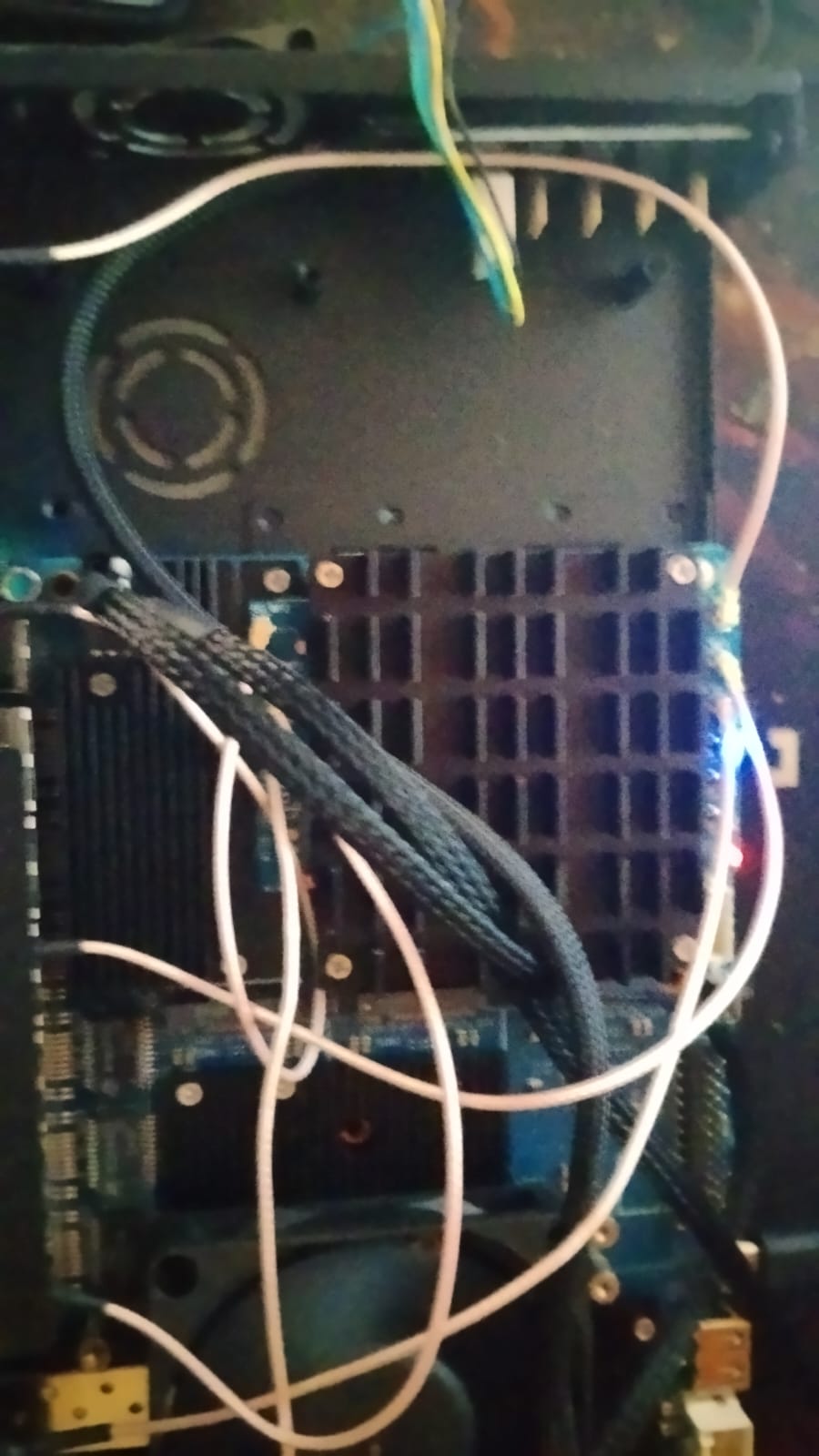

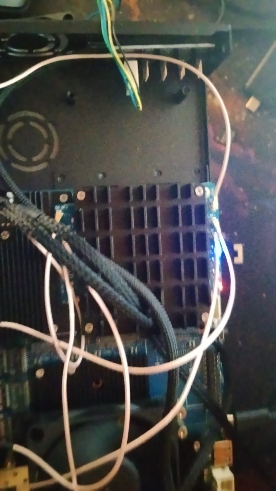

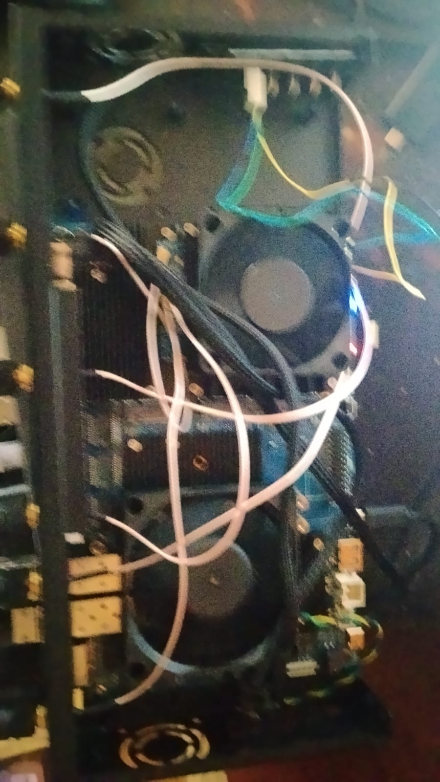

Good afternoon. As the images show, the one they sent me fits perfectly once installed on the board.
Mine arrived as I’ve shown you: first, place the gold-plated components on the motherboard, then the heatsink, and finally the screws.
It fits perfectly, at least what they sent me.

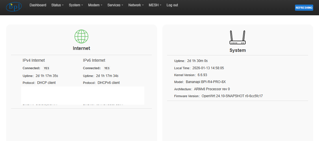

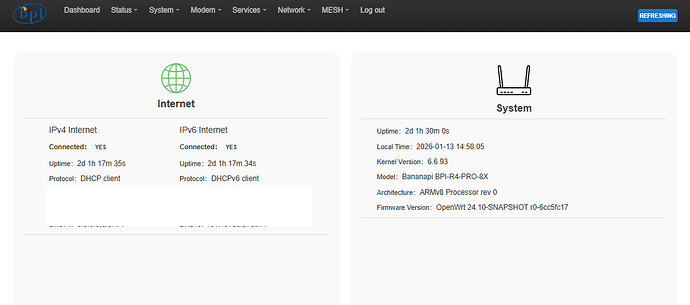

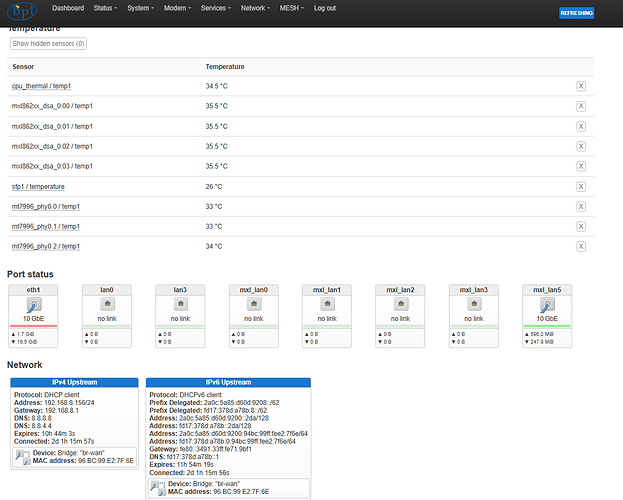

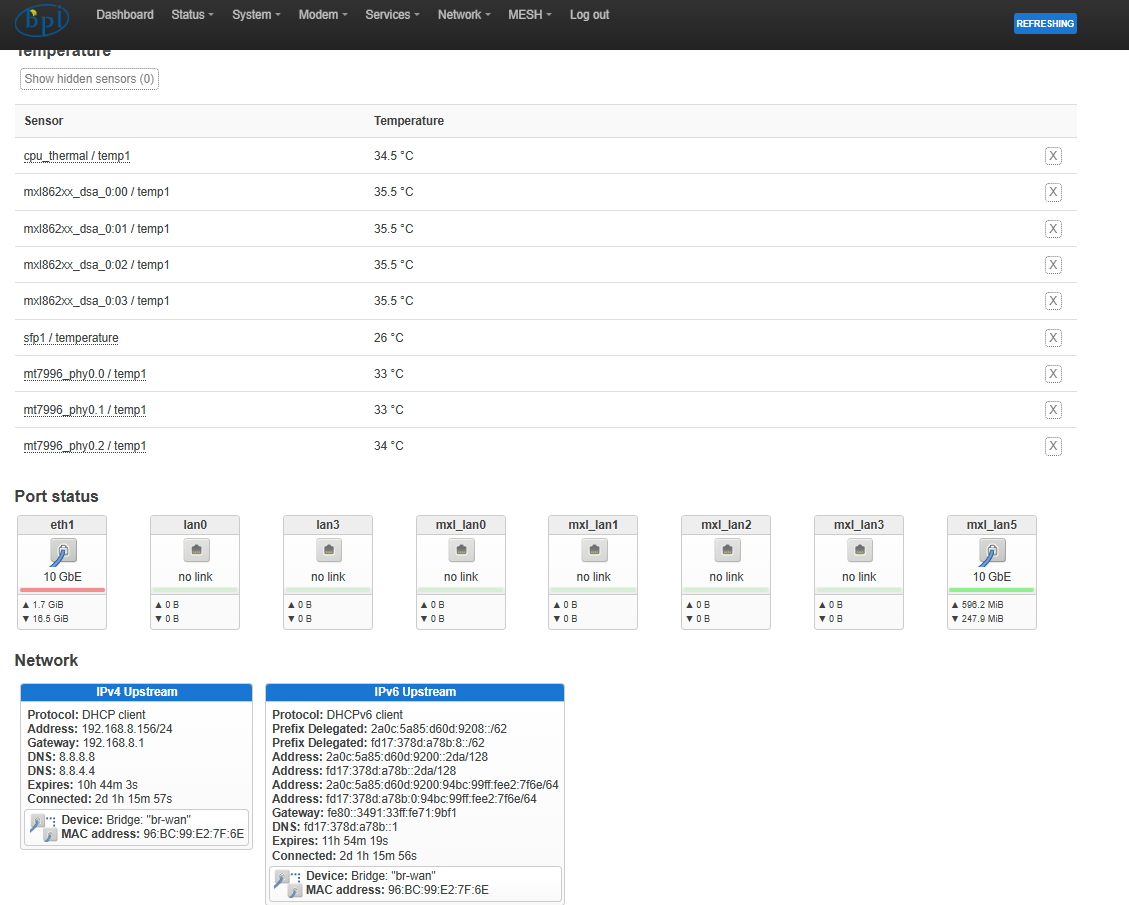

I’ll leave you with the current temperatures.
Regards
There’s no way in hell that those fit on the normal bpi-r4. You have the pro version, so they fit. Also, i don’t have spacers in be14, i have holes.
I apologize, I’ve always referred to the Pro version. It’s not compatible with the regular Banana Pi R4; it mounts underneath the board and doesn’t fit in the current case. Besides, I’m not sure if it uses the same mounting hardware as the Pro version.
I’ve always referred to the Pro version because it was designed for that board.

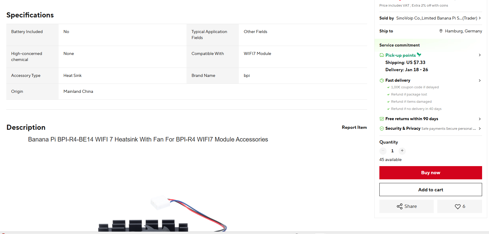

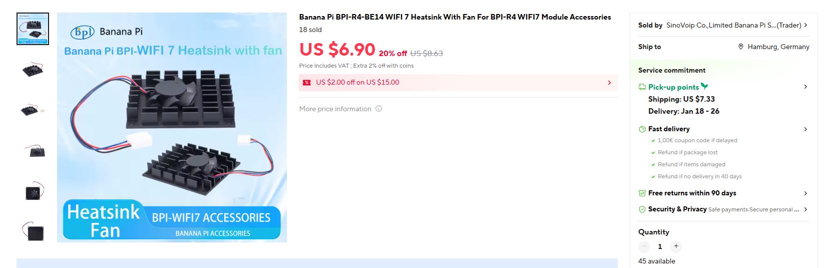

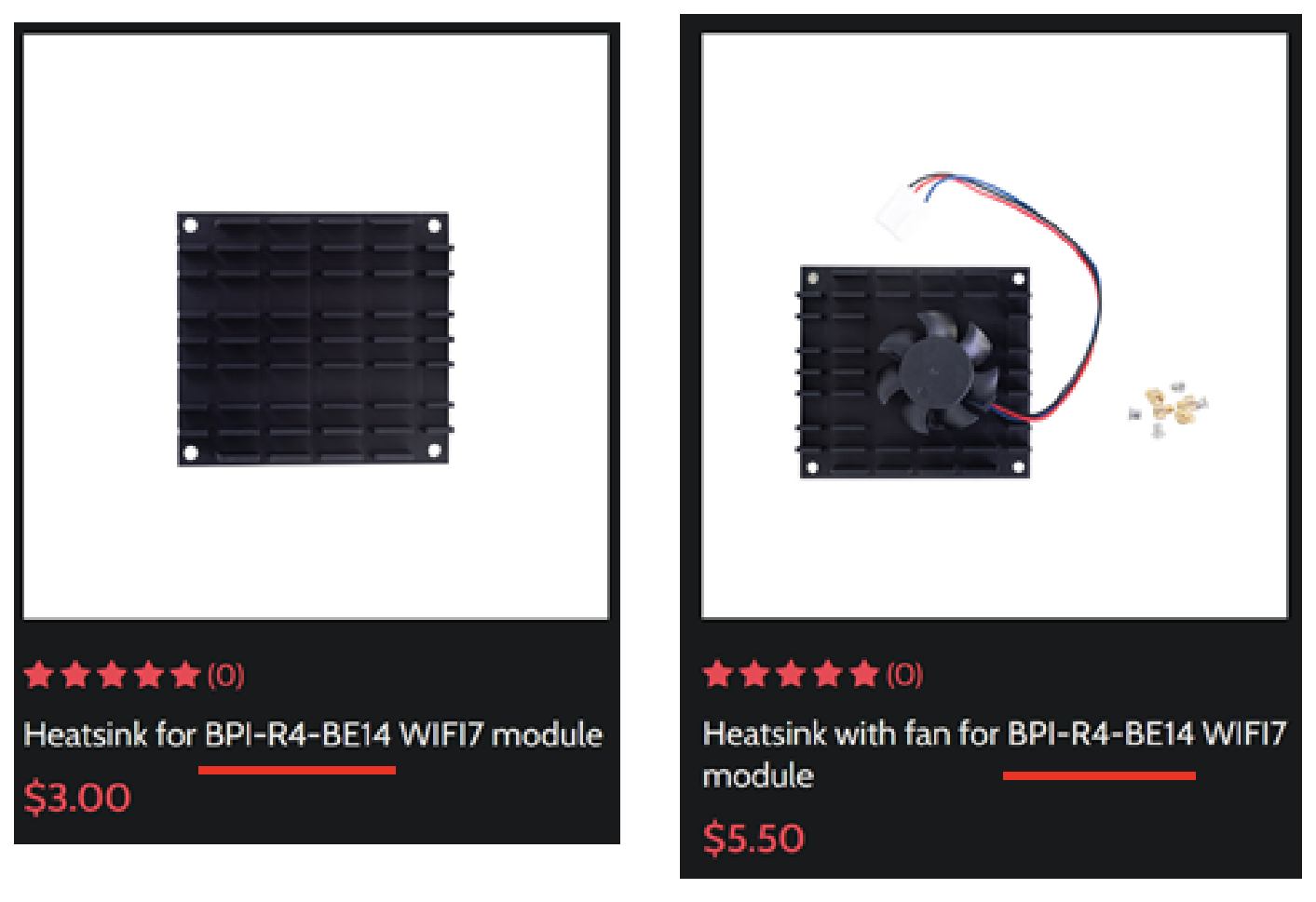

I’m very curious how my two heat sinks / fans will fit (in the also ordered new version of the case). In the sinovoip shop of aliexpress it is clearly referenced as as made for BPi-R4 without any mention of “PRO”.

Those heatsinks will not fit in standard bpi-r4. Those are only for Lite and Pro version.
For R4, the original cooling concept relied on the chassis.
→ Nothing on R4 lines up with the mounting holes on THIS heatsink :see_no_evil:
R4 needs a dedicated heatsink, and it’s not available for sale at the moment :joy:
But the taller case is on sale… :thinking: I’m not sure what will happen now:
  • New release of the standard R4 board
  • Abandon R4…

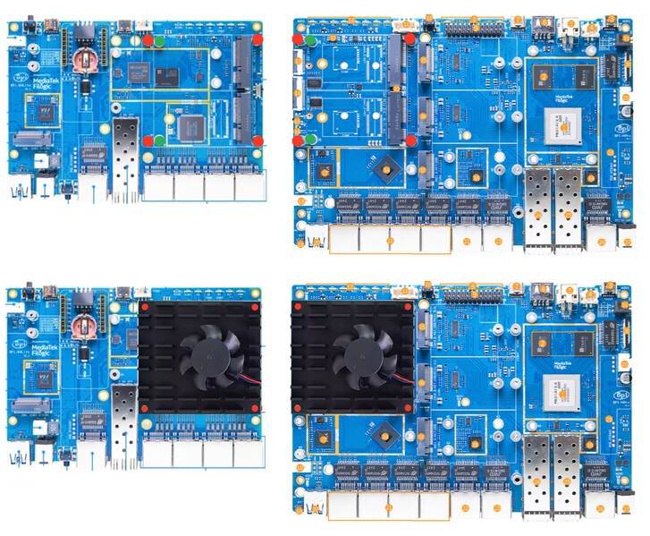

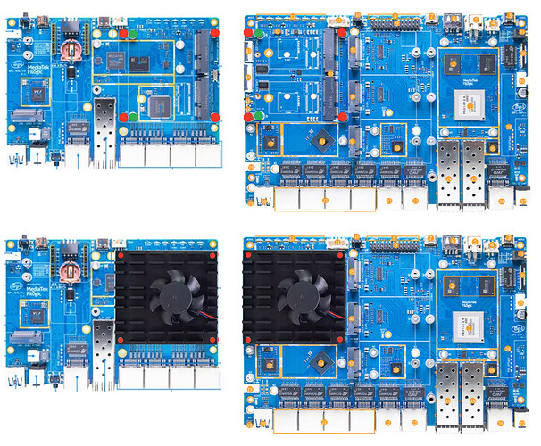

→ R4 Lite and R4 Pro have four additional PCB mounting points for this heatsink.
This cooling fan is exactly as described below - it is only applicable to R4Lite and R4Pro. I have informed the relevant personnel to make the necessary modifications to the website.
