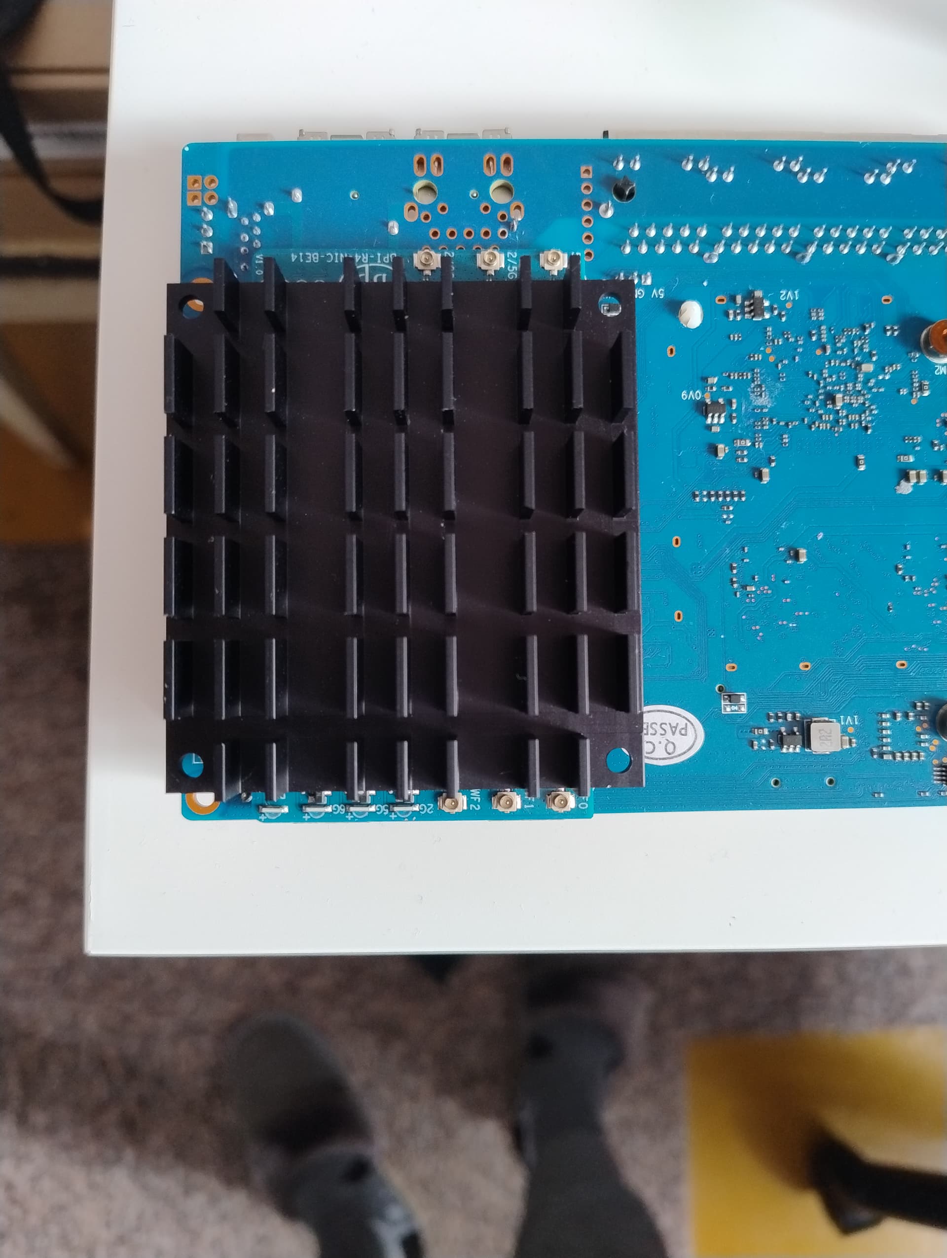

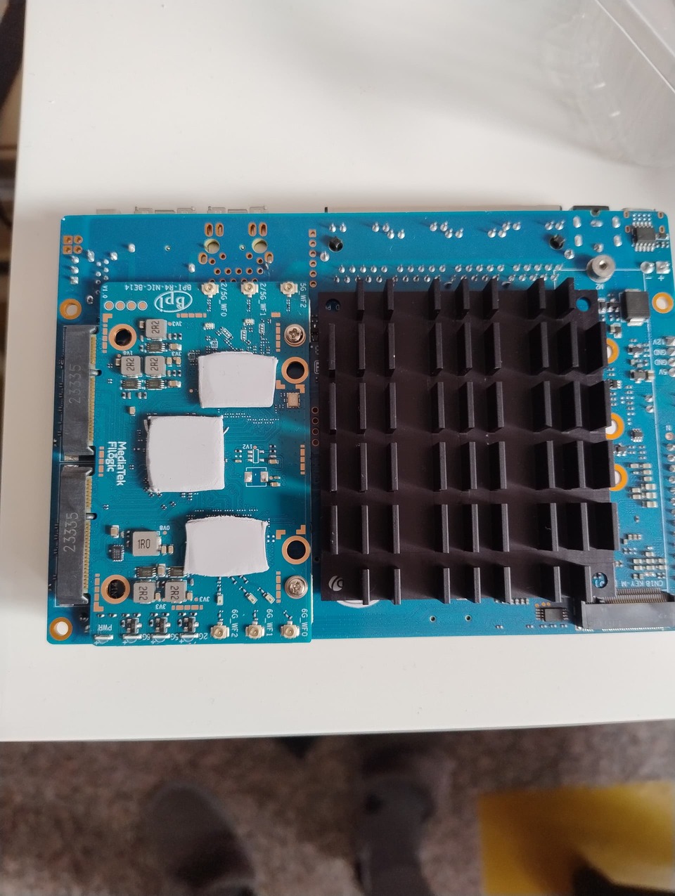

Why do you need a radiator for a non-working be14?
BE14 is operating normally and has been widely used by commercial customers. However, it lacks isolation for PA. We are currently designing a version of BE14 with isolation. BE19 is also undergoing the second round of hardware improvements and will be released soon.
