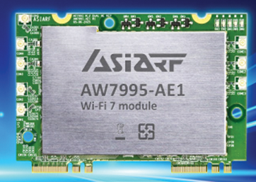

To complete the topic:
The AsiaRF BE14000 is now available:

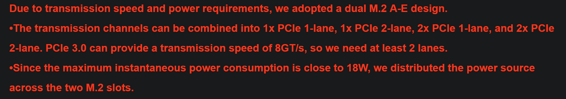

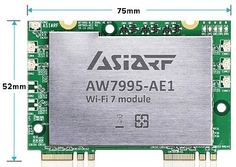

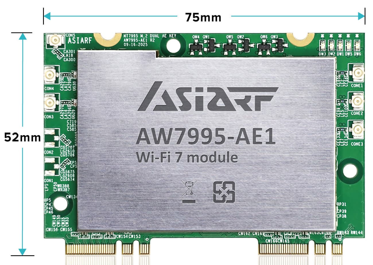

I see that this module from asiaRF is not physically compatible with the bpi-r4.
Yes, to run this in a BPI-R4, you would need something like this:
https://de.aliexpress.com/item/1005004984753432.html
But you can only use 2× PCIe 1-lane, which could may be enough?
It looks like external power could be supplied to the adapter.
But… I don’t think it’s worth the work! Waiting for the next BPI-BE14 version may be the better option.
