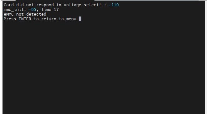

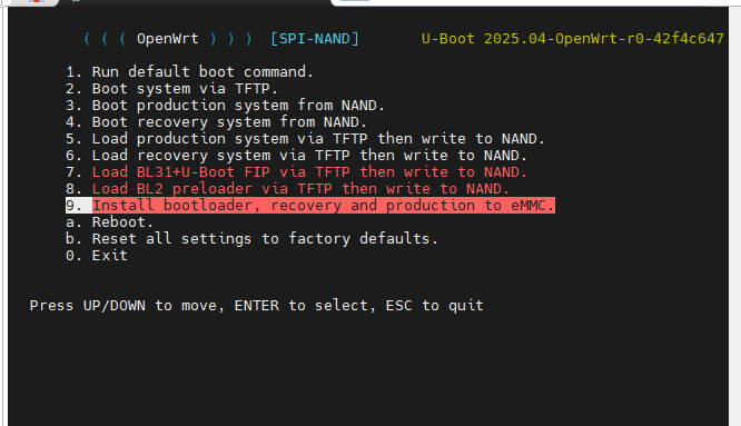

Apart from that, I was then able to upgrade the firmware, since after the GPT partitioning, the partition “firmware” exists. But. The following boot fails.
Ah, I noticed a single_img_wrapper-directory in the arm-trusted-firmware/tools/dev-folder but am unable to see, if this works with an itb file right now. Will test it tomorrow :slight_smile:
Tried a lot of stuff but can not generate something which is worth to call stable or at least good enough to test the board properly. In the pre-installed 21.01 version, a lot of bugs and performance issues are present. I just want to use the board without Wi-Fi for now.
I think the U-Boot needs a fresh build too. But I have to dive into that fist. Found something here: https://git01.mediatek.com/plugins/gitiles/?format=HTML
Thanks to @slapstick559 I could build a custom 24.0X image (+U-Boot, +ATF) and it works more stable as the 21. After some tests, I put this thing to production :wink:
