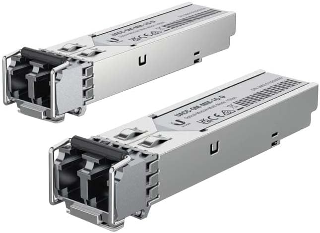

Question: Am I correct to think this could work between my Ubiquiti ER-X-SFP to the Banana-Pi 4?
- Banana Pi : install a Ubiquiti uacc-om-mm-1g-d-2
- Ubiquiti : Install a Ubiuititi uacc-om-mm-1g-d-2
- Fiber cable : which one do I need? āmulti-mode fiber with a duplex LC UPC connectorā? See URL below to fs.com
Notes: The Ubiquiti module is this one. It is the same as the one on Amazon I posted earlier:

I think you are correct - if you have those Ubiquiti SFPs on both side you need a multimode cable with those LC connectors on both side, so a multi-mode fiber with duplex LC UPC connectors on each side is the correct cable.
Just to note: It is not strictly required to buy a duplex cable - you could also buy two simplex. Obviously to pull a duplex cable through the tube is more hassle, as it is twice as thick and has two connectors next to each other adding even more diameter. And if you pull those patch cables, you also have to get the connectors through the tube.
Also those patch cables are usually not that āpull resistantā, e.g. short term you can pull with 150 N (approx. ā15 kgā) so when you pull the cables, just keep in mind to not put too much force into it
but I never ripped one apart so farā¦

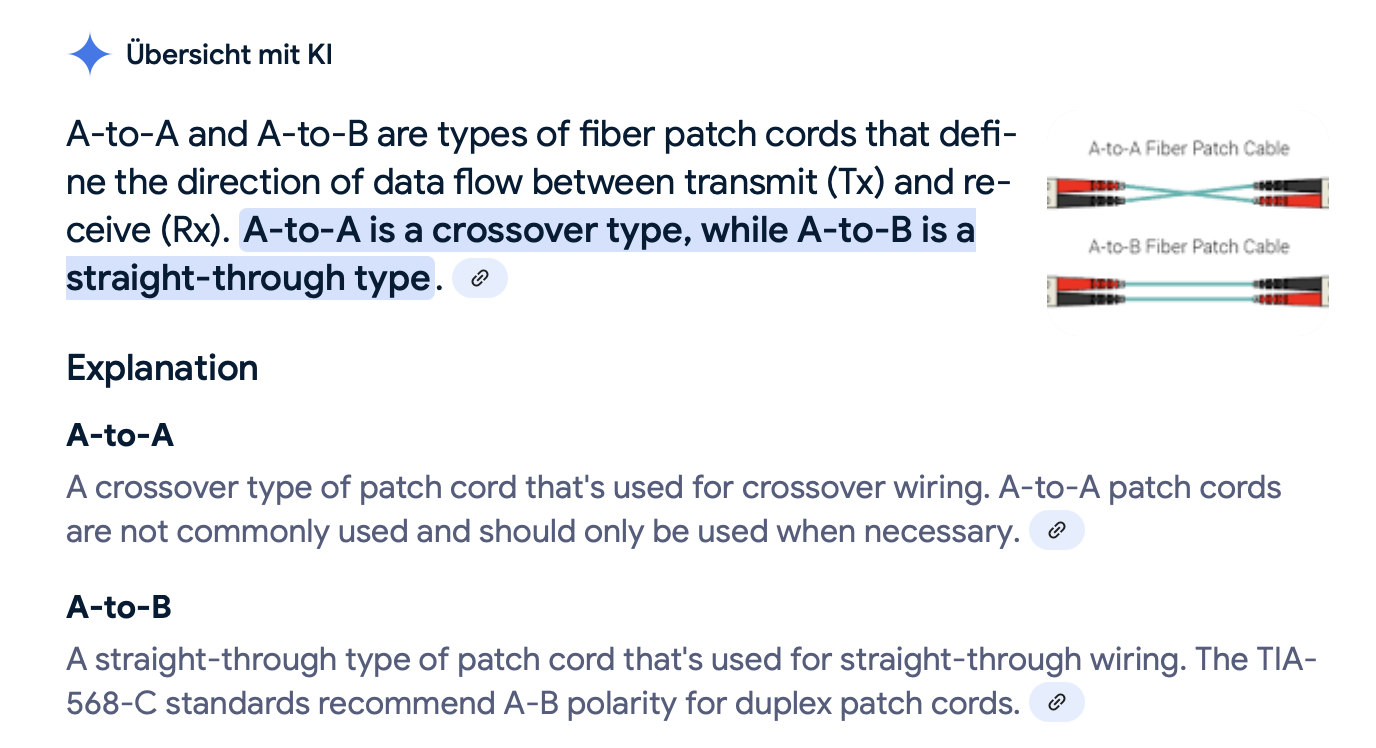

I never used duplex (as I use those BiDi, which only seem to exist for single-mode fiber). But this A-to-A or A-to-B is just a description if the cable is crossed (A-to-A is crossed, A-to-B is straight). But as said, you could change the plug, if the cable would be wrong. The plug actually consists of two plugs with a helper-structure which you could just unclip and change: https://www.youtube.com/watch?v=KFRxCfN6JY0
I just googled it: āfiber a-to-a or a-to-bā:
Now this is easy. Thanks for the video
