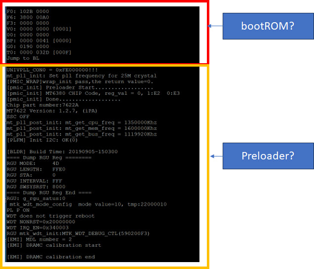

Hi. guys.
I don’t quite understand the relationship between bootrom and the preloader.
As far as I know, the preloader is stored on the eMMC (/dev/mtd0). However, even if I delete all of /dev/mtd0 with the command below, the preloader still works.
$> mtd erase /dev/mtd0
The attached image shows the result of a reboot after I deleted all of mtd0.
mtd0 = nand
mmcblk0 = sd
mmcblk1 = emmc

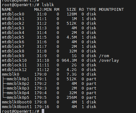

However, it is important to distinguish between SD and eMMC by either their size or their partitions. For example, the following:
7f8580d8a77fc67832262ee202bea960
From this diagram, it can be seen that mmcblk0 has a boot partition. Therefore, mmcblk0 should be an emmc.

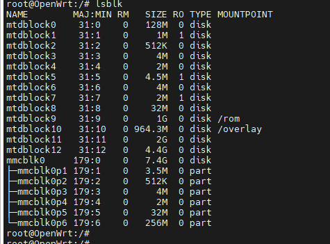

6383da4f0423ce67320da6d0787fcdfd
And since there is no boot partition on mmcblk here, it must be an SD card.
