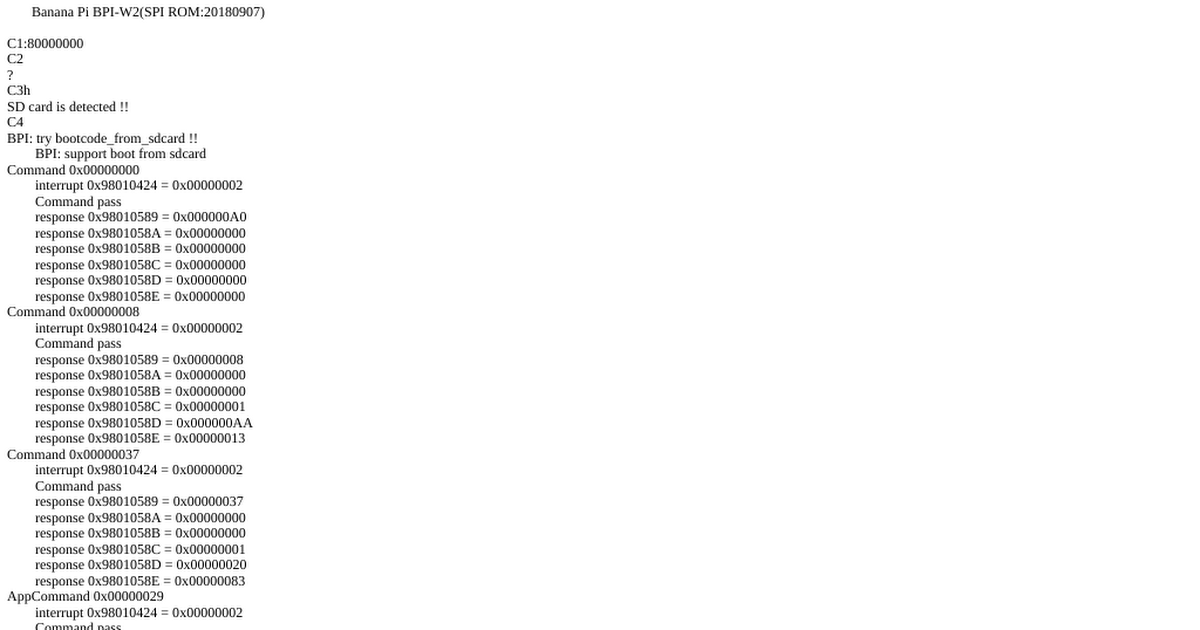

Hello, We need hibernate in our project because equipment works on accumulators and Qt program runs only occasionally. I compiled the kernel that supports hibernation and configured swap partition.Grub configuration is done through /etc/default/grub/ In spite of these efforts after execution pm-hibernate the system wakes up only on power-on and loads from boot_from_sd (boot from SD mode; secure_mode 0), which takes two times longer than it was before I have activated the hibernation in the kernel. Does anybody successfully hibernate on BPI-W2? Does ARM Trusted Firmware for ARM Cortex-A support wake up from hibernation for the guest Operation System? Best regards, Alexandre
P.S. The starting log is attached below:
